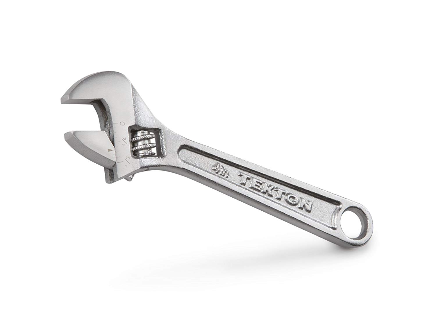

Zero luck after several calls? Who the hell did you call?!
So many different options.. Check the stickies on the top of the forum.
Easy approach: Add .75-1" cornfed top spacer.
