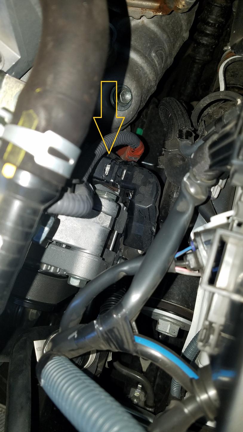

Sorry to bring up this old thread as I don't have enough posts to start a new thread. Anyhow, I'm attempting to do the big 3 with my stock alternator. on my 2016 SR5. Does anybody know how to get this cap off of the positive terminal of the alternator in order to expose the nut? I can't seem to get it off unless I physically cut and break the cap. Any ideas on how to get to it? Thanks all.
Hi sdub22,
Removing the output stud cover is pretty simple; sorry, but this is the best photo that I could fine since Photo-bucket has been fukin with my albums, but this may still may be helpful if you could see the stud's vertical position and the base that the cover snaps on to. There is a plastic latch that keeps the hinged cover on until you unsnap it using your fingers and just lift the cover up! ..."see below":

Hope this will be of some help; 'Best to you',
