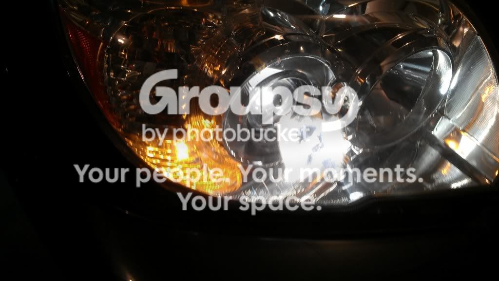

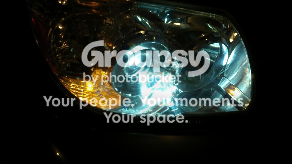

I have never seen the need for the 55w system. I just installed a morimoto HID pnp kit from The Retrofit Source online: headlight upgrades for all applications and couldn't be happier with it. It really is top quality. I had issues on my 03 with pnp HID kits, so I definitely recommend using a relay harness. Here's what my 4300K morimotos look like.
Before
IMAG1208.jpg~original
After
IMAG1215.jpg~original

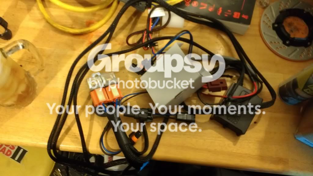

Here's a pic of the relay harness, you definitely want 1 of these
IMAG1213.jpg~original
Iv had mine in for a year from DDMtuning and theirs no problem with any errors but i second that relay harness i will say that one of my bulb did change color but DDMtuning replaced it for free within the lifetime warranty that comes with there kits
The relay harness connects the ballasts to the battery with a relay so that the heavier draw of the ballasts doesn't hit the stock headlight wiring as hard. I had a number of electrical issues in my 03 without using a relay harness
