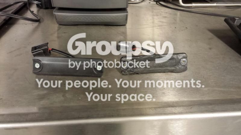

anyone else have the hatch opening switch melt?
corradovrt
my hatch has been extremely difficult to open since i got it. finally last week i noticed that the switch rubber was essentially melted. so i ordered a new one and put it in tonight. now it opens with the slightest touch, so much better
Replace Rear Hatch Opening Switch
I just replaced my rear hatch opening switch on my '07 Limited today. I found a new part on ebay for $48 with free shipping (Part# 84840-35010). I referred to the post How to: Replace Rear Hatch Opening Switch - Toyota 120 Platforms Forum for info on how to replace it. It worked great.
In that post, they mention there might be a removable cap to get at the nut on the driver's side - there is. Also, I had a bit of a hard time getting the top of the exterior trim with Toyota Logo loose - if you look inside and up high just above the wiper motor you'll see the end of a square white clip/tab with a round metal piece in it; take a long Phillips screwdriver and put the tip of it on the center of the clip and tap lightly on the handle of the screwdriver and it pops right out; there other two additional clips/tabs that need to be pried out with a trim removal tool that are located right behind the license plate lights.

I see this more commonly on BMWs, Mercedes, Lexus, VW, ect. Mine on my '04 has been nice and smooth like the day it left the factory. But I think over time (possibly in saltier, dustier, maybe even more humid areas) corrosion of one form or another starts to create resistance and/or break down the rubber material.
