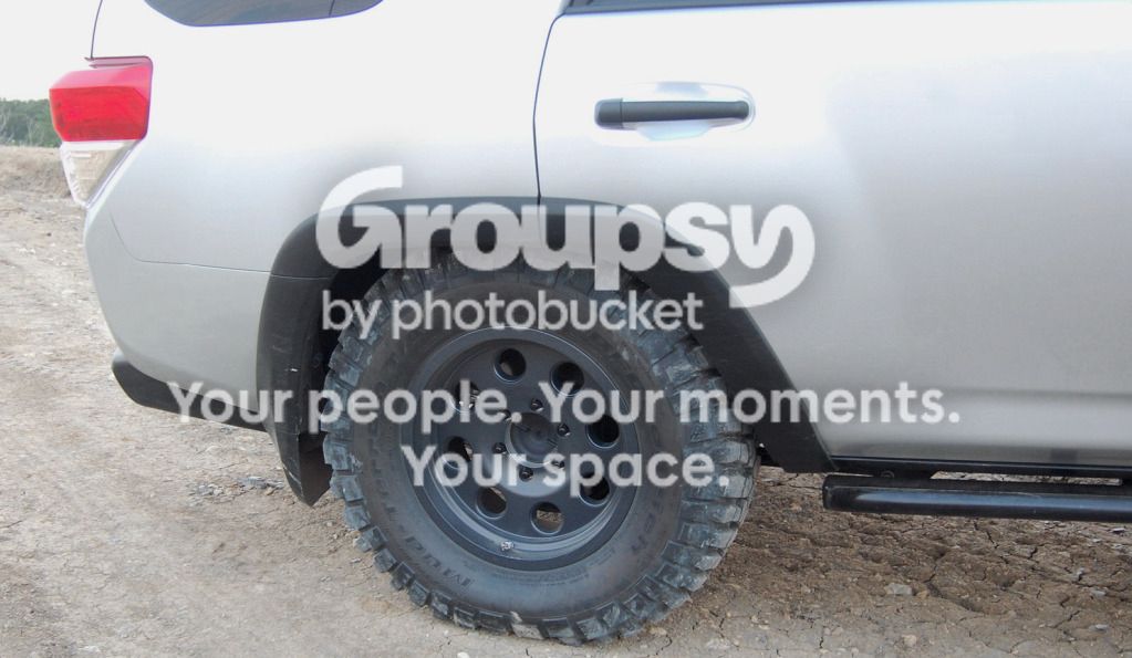

With my 305/70/17's (34's) on my Konig X's(only 8"wide,not 9) I rubbed big time in the rear wheel well fender lips when fully stuffed. Chewed up the outside lugs on the rear tires pretty good in Ouray.Pretty much restricted my offroading there as I had to watch not to stuff the rear wheels and the reason I didn't go to Moab ....No es bueno!lol
Never rubbed at all with 305/65/17's(32.8')on the Konigs, so an inch+ bigger tire made a big difference.
Talked to the TRD chief engineer in Ouray and showed him my damage and he said it was because of the .4 offset of the X's plus the 34" tires.
35's would have trashed the fenders or blew the tires.
He said the Fuel wheels they ran in the Baja 1000 were custom 8 inch wide with a 4.75 or 5.0 backspace(+6 offset) so they wouldn't hit the rear fenders .
I recently put on Metaltech 2 inch bumpstop extenders in the rear for at least a temporary fix. Limits the up travel by 2 inches so it won't rub .
This is pic, stuffed(against the bumpstop)with a 305/65/17 KM2 and a 8" wide Mojave with 4.5" backspace (0 offset) and you can see how close it is.The other side is at full extension running extended travel Icon piggyback shocks.
Picture010_zps077c16f8.jpg~original
Thank you sir for sharing that info!
So you're saying its not a good idea for my setup to run a 305? The wheels have 5in back spacing and a 0 offset. I guess I could just run a 295 and call it a day.
