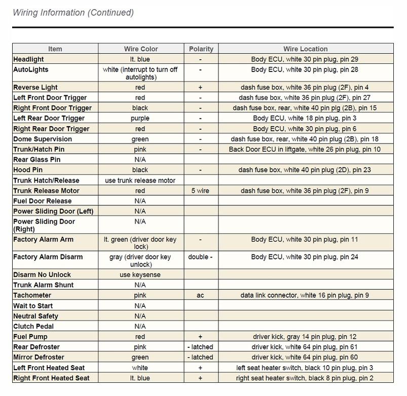

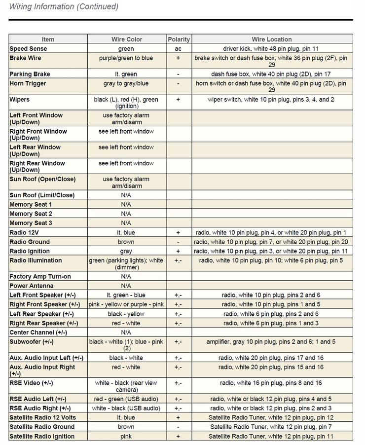

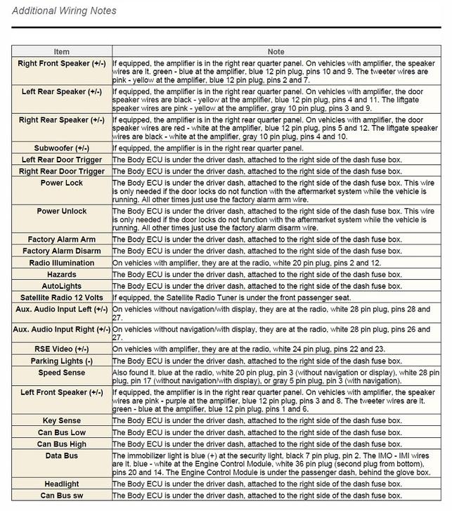

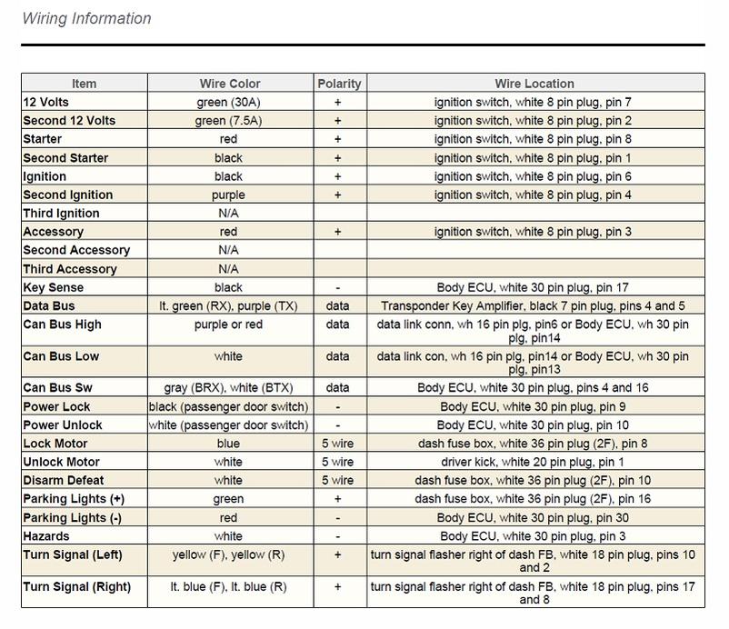

This is what I got from someone who has access to the Directed Electronics wiring information database. Most of the wires seem accurate when I was doing my alarm install on my 12' TE w/ nav. Hope it helps!

Don't know if you're still interested, but the "optional JBL nav system", has it's power amp located in the R/R storage compartment, over the wheel well.
The "non-JBL nav system" has it's power amp, built-in to the head unit. I'm still trying to find a way to copy/paste the pages that you want to see, here; I'll let you know if it can be done.
Very useful pinout information. Thank you!
