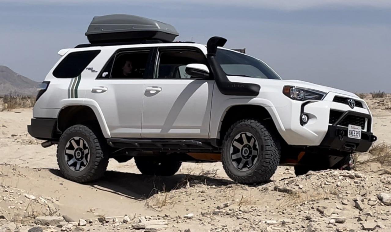

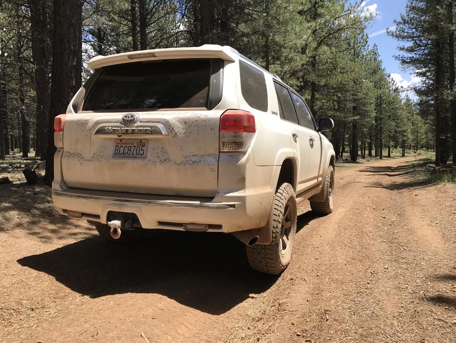

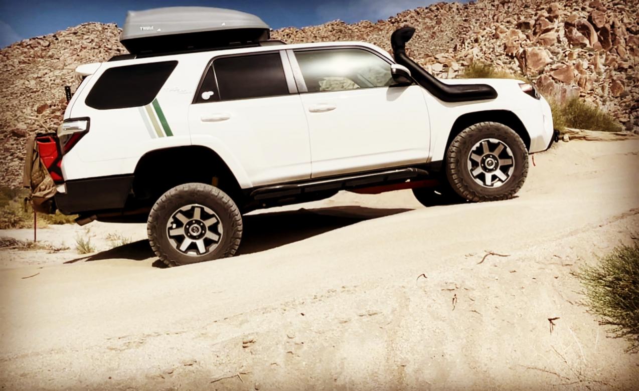

Anyone have 265 tires with a lift?
2.75-3” lift with 265’s
265’s with Eibach
I have the Eibach Stage 1 kit but used the factory springs on the top perch and it looks great and works great even with the factory Dunlop’s!
