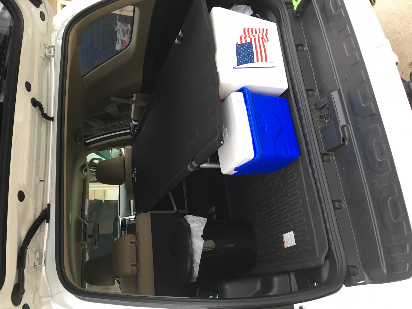

I found a cot that fits perfect over folded 2nd row and wheel well. My daily drive and grandson mover with child seat in 2nd row and camper when on a outdoor trip.
At 6'3" I just can't fit comfortably, maybe with the hatch open and my feet hanging out but I worry they may look appetizing to any bears in the area.
