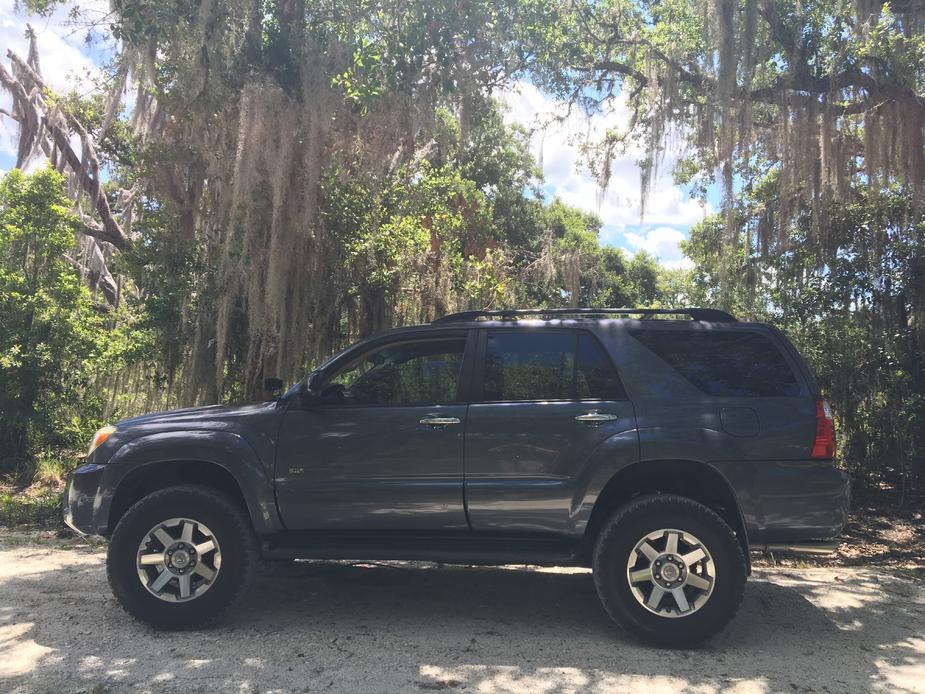

I've been rocking the Procomp spacer lift for years paired with DayStar spacers in the rear. Looks great! It is ironic that I just happen to be installing a new Icon Stage 2 lift today, so if you want my front and rear spacers I will gladly sell them to you for $100 plus the cost of shipping. Just let me know. Here is a pic of my rig with the spacer lift (plus 1.5" body lift). You can learn more by visiting my build thread, just search "Old Grey".
