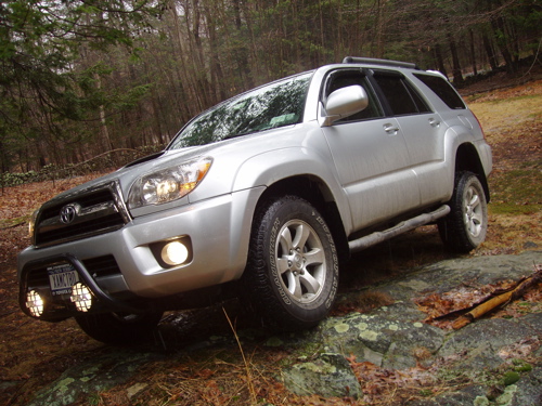

4th option
This is probably the most difficult of all the options. I did a modified version of Momo's floating lights. Then added a brush guard to help prevent damage from taps/bumps. I've been very please with the results. Since these photos I have added PIAA locks for some security and to cover-up the connector bolt below the lights.
lights4.jpg~original
IMG_0400.jpg~original
I can't find the thread, but there's a member here who cut out his lower grille for rectangular PIAAs. The PIAAs were a driving and fog combination lamp, with a projector for one of them.
I mounted some Eurolite driving lights behind the lower grill and used the mounting plate that came on the lights and simply screwed one self-tapping screw into the frame crossbar. Easy and dont have to get other mounting brackets or bull bars. Gotta be careful of melting your grill though. Ill post picks if i can find them when i get home.
Re: 4th option
That looks really sharp. I like it a lot. Wish id a got a black 4r
