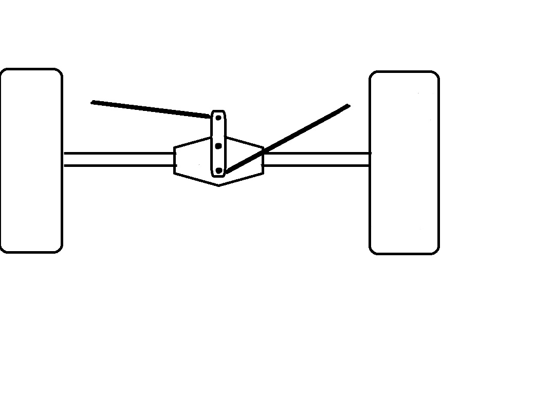

I had the same thought about the diff hitting something under the frame. But I think you would hitting bump stops before that became an issue. And you should definitely experiment with this! I would love to if I had the time and money right now. It would surely take some careful planning to make everything fit just right. But I love the idea of having coil springs combined with an axle that stays true center all the time. Would be an advantage for off and on road driving.
I posted the video with the crc version because I know the biggest aversion here would be the lower bar limiting some off road capability. But even with traditional watts linkage you can move that bar up to the point where it shouldn't affect rock crawling. You just mount the pivot bracket higher on the axle and then angle the lower bar up a bit. That's what I would do. The crc version looks more difficult as you have less space to work with, and the bars need to be able to move in any direction
Something like this. The rod on the right side is longer than on the left, but that really doesn't matter over the course of 12" of travel, or whatever our lifted trucks have. The geometry would still work

Edit: You can still design traditional watts so that it wont interfere with anything off road though. Like in the drawing I posted. You can google search it and see some good watts set ups for off road.
LOL. I didn't watch the video. This would be the set-up I'd run over a watts system. It's just as functional and everything is up out of the way.
Yeah. Well, functionally its identical to watts, just oriented differently. Positioned on top of the diff would obviously be ideal for off road. For myself, I don't really do any serious wheeling, so I would be fine with traditional watts. I would just try to locate it high enough so the bottom bar is no lower than the axle. In that case I would never have any issues on trails. Just wouldn't be suited for serious stuff
