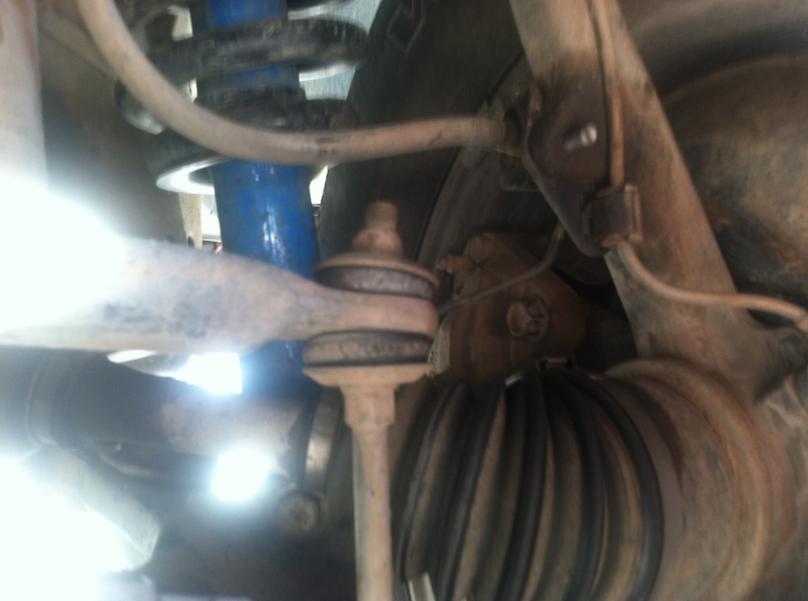

Could end link bushings like this be causing the problem?

CV's click they dont pop, i would check your front lower control arm bushings, on my jetta the bushing i changed out 30k miles prior and the bushing shredded and made a pop and clunk when i would turn left and it got really annoying. So chances are thats your problem. So buy some LCA bushings and throw um on there. Your description of the problem is exactly what mine was when i was trying to figure it out.
The swaybar end link you posted looks normal, that work really pop like an LCA will.
