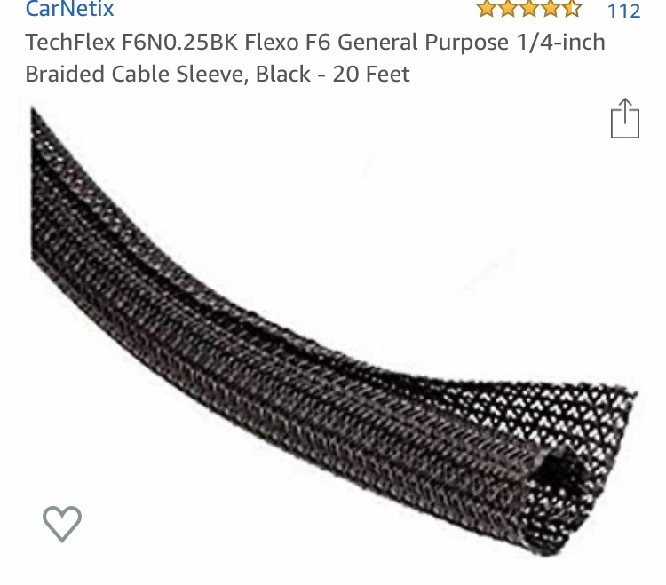

Good luck. It’s not that hard but be careful and deliberate and do a clean job soldering. I like using this cable braiding sleeve to protect the wires from abrasion (TechFlex F6N0.25BK Flexo F6 General Purpose 1/4-inch Braided Cable Sleeve).
https://www.amazon.com/TechFlex-F6N...ch+Braided+Cable+Sleeve&qid=1574669837&sr=8-1
