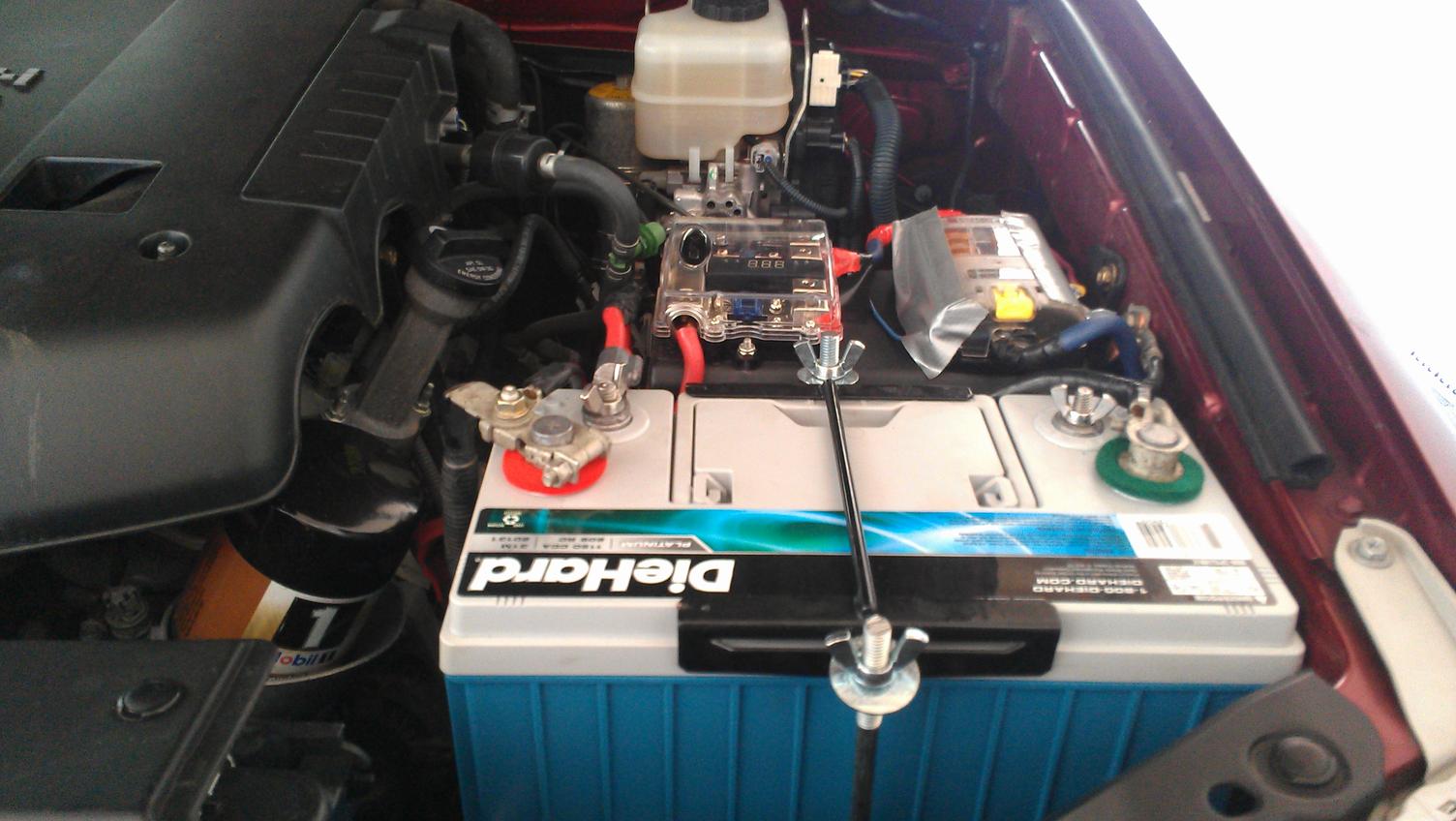

I don't have dual batteries in mine. I have Sears Platinum Marine 1160 CCA battery that should be sufficient to run my accessories. I use a power distribution block from the battery and then to a aftermarket fuse block.
Small things like the compressor get power from the aftermarket fuse block. Large things like my amp get power from the distribution block. Both are fused.
Is this Sears Platinum Marine the same size as the stock Panasonic or wider?

That battery is a lot longer than the Panasonic. The Sears is 13 inches. I had to put in a new battery tray.
Hey man i have a quick question for you. I am planning on putting that same battery in my 4th gen and i am trying to decide between trimming the lips on the stock battery tray or replacing it with something better. Do you have a link to the aftermarket tray you got? Is it hard to swap the trays out?
Im wanting to put an ARB compressor in but want a beefier battery for it just incase. Just gotta figure out how to mount the sucker near the v8 airbox!
I don't remember where I bought the battery tray. It was not an expensive one. You could trim the factory tray and be ok. I don't see the value in these $100+ trays
Yea I think ill just trim the stock tray and use all the factory gear, mounts, and bolts and stuff. Should work out. Any money not spent on the tray can be used for other stuff! :D
