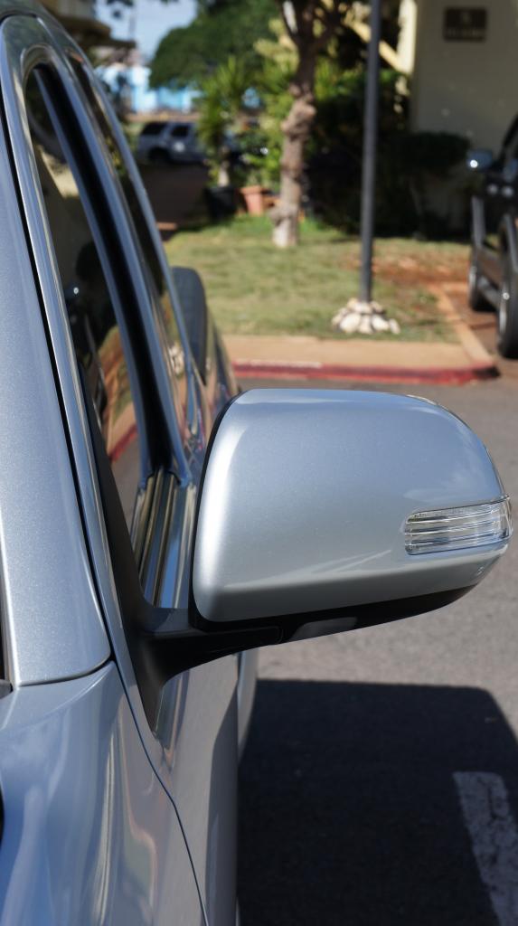

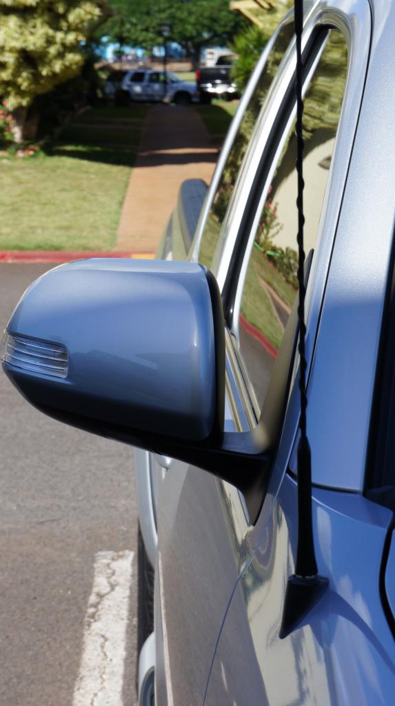

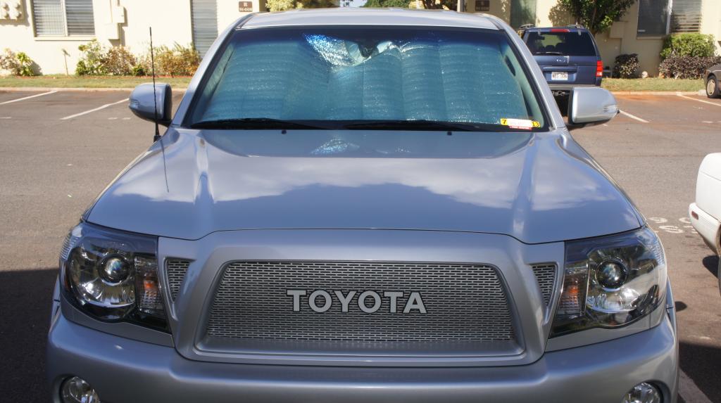

Here are some pics of the 5th gen 4Runner mirrors installed on a Tacoma

When just looking from the outside, the Tacos and 5th gens seem to have the same mirrors anyway which would make sense as to why it would be easier than on our 4th gens. As previously mentioned, it seems that some Taco owners were just placing the 4runner mirror onto their factory stem/mount.
However, I don't think this method will work with our mirrors due to the mounting/swivel area being shaped differently. See THIS guide for a look at our 4th gen mirrors disassembled and HERE for a look at the 5th Gen internals (NOTE: these pictures are the "Kool-Vue" aftermarket brand so OEM are possibly different). Judging by their shape alone, it looks they won't match-up (4th gen base and 5th Gen 4runner mirror assembly). Maybe (hopefully) i'm just missing something. I guess the only real way to tell would be to try it out.
