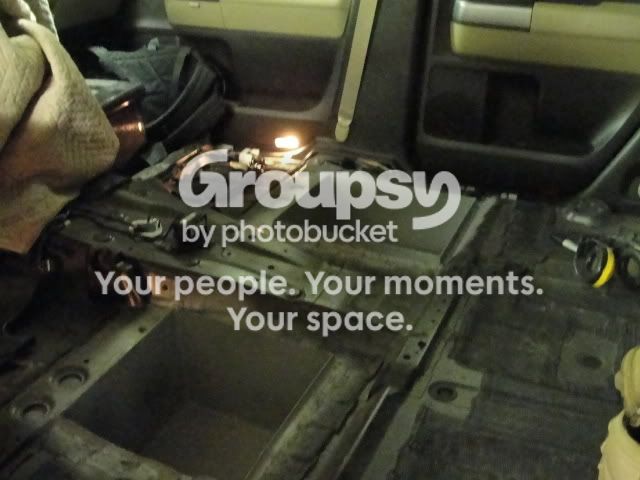

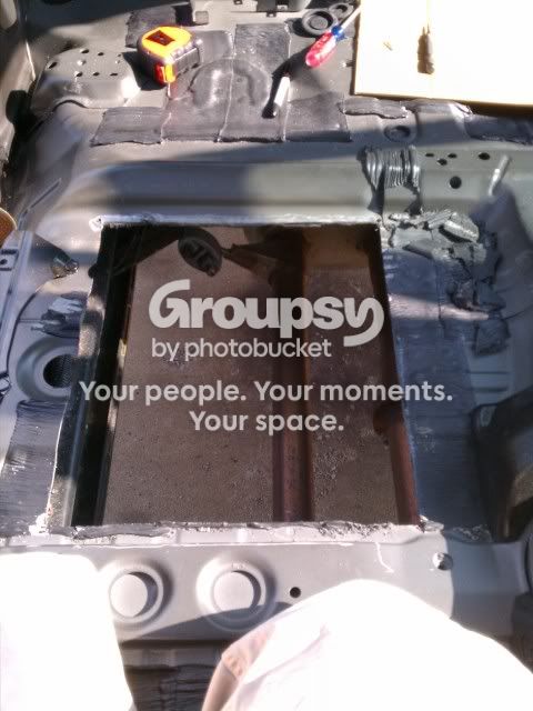

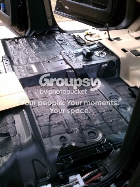

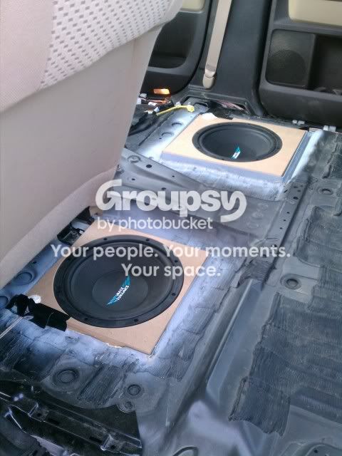

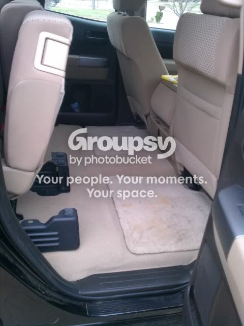

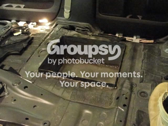

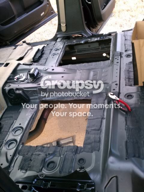

Here's my 2010 Tundra about a month after I bought it new in August(ish) 2010:
IMAG0166.jpg~original
IMAG0169.jpg~original
IMAG0173.jpg~original
DSC01369.jpg~original
DSC01372.jpg~original

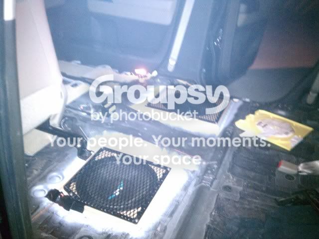

I'm a big fan of the IDQ12's! Very responsive bass and they sound amazing! Both of these boxes are sealed which helps the crisp responsiveness of the subs though.
IMAG0216.jpg~original
IMAG0228.jpg~original
IMAG0238.jpg~original
I didn't document anything on the front stage though but it's a 3-way active setup on a Zapco amp.
I am a huge fan of Zapco (Zapco - The Driving Force) amplifiers. Their sound quality is amazing and they have anything from high end competition amps to every day regular guy amps.
I have heard good things about rainbow but I don't have any experience with them. But, for the price you could get a morel front stage and get known good results. Morel coupled with Zapco is a winning setup.
Thanks Thai! The idea was to have a kick a$$ stereo in a truck that looks completely stock. I modified the dash of the truck to put some 3" mid range speakers in the stock location and had to heat and reform the passenger side heater duct to make them fit. I put the tweeters and the mid bass speakers in the stock location as well and tried to aim the tweets as good as I can while keeping the location stock. A buddy of mine built a wire harness to run from the stock head unit to a smbyalink port on the Zapco amp. That harness balances and cleans the signal from the h/u to the amp so it produces a clean signal to the amp to amplify.
