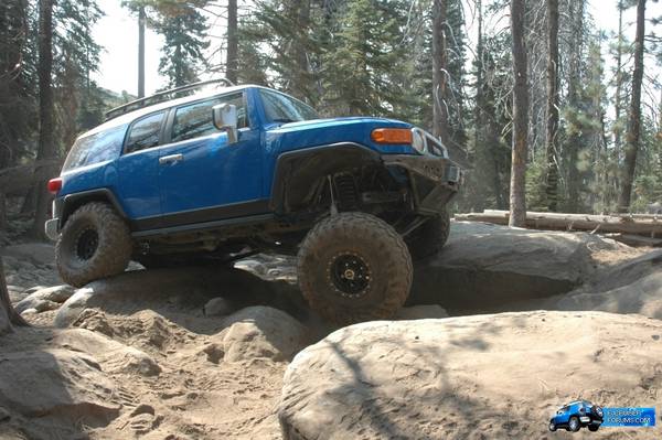

Here's an example - it's a photo of an FJ Cruiser with LONG TRAVEL and the SOLID AXLE SWAP (note the front axle and the over sized coilovers)!
Mike :artist2:
Mike :artist2:

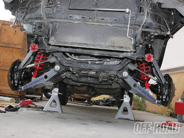

That is only an example of a solid axle swap. Here is an example of a long travel kit. It just replaces the stock control arms with longer ones. Allows for more travel.. get it? Haha
Sorry, small pic. Just image search it.

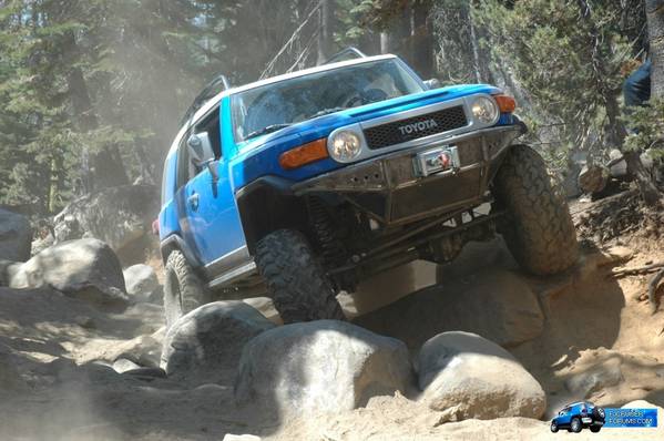

You talking about this...? :thumb3:
Mike :artist2:
Ok, so it's a solid axle with lots of articulation, still doesn't make it a "Long Travel suspension." SAS and LT are two completely different suspension systems. Long travel is an independent front suspension system, while the solid axle is.. you guessed it.. a solid axle.

This is what a TC LT (Long Travel) kit looks like for the 4th Gen 4runners and will probably fit the 5th Gens. The problem lies in modifying the fenders to handle the increased width and travel.
Now that that is cleared up, someone with some Photoshop skills (not me) should chop a photo of a 5th gen with one of these setups! :D
You can have a long travel straight axle suspension just as you can have a long travel IFS suspension. The term "long travel" isn't only for IFS although it is more often used when talking about IFS
