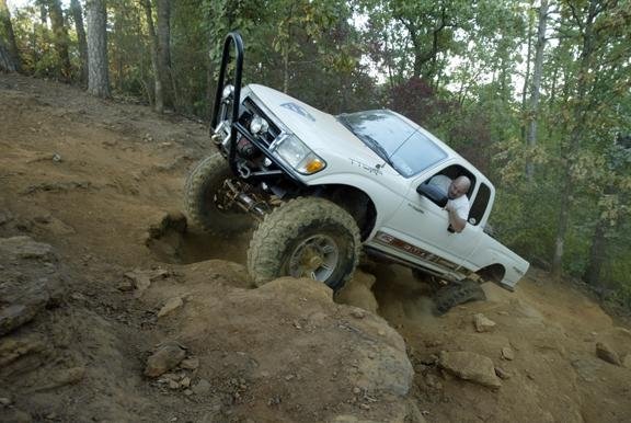

Back in the day I use to think everything needed a solid axle. I did both of my Tacomas, and one old 4runner. I considered it on my 4th gen when I did the 4x4 conversion, but changed my mind. I did however buy 90% of the parts for the conversion including Dana 60s, Coil-Overs, Johnny joints, hydraulic steering, wheels, and a bunch of small parts.
Now that both of our 5th gens are paid off the wife wants a new Highlander, I told her I would get it for her if I could SAS her 4runner.. Truth be told, I think I'm past the SAS stuff now. I prefer my vehicles be able to take me long distances, to remote places and back.
My SASed Tacoma above was also my DD at the time, and it wheeled very well on the rocks, it did pretty good on the loose stuff.
