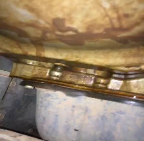

I snapped a photo of my rear main and put it on antmans oil change write-up page 42. I have 8k miles on my 2016 but something tells me my rear main will look like yours at 36k. Gonna keep an eye on it and make sure I don't miss the warranty window.

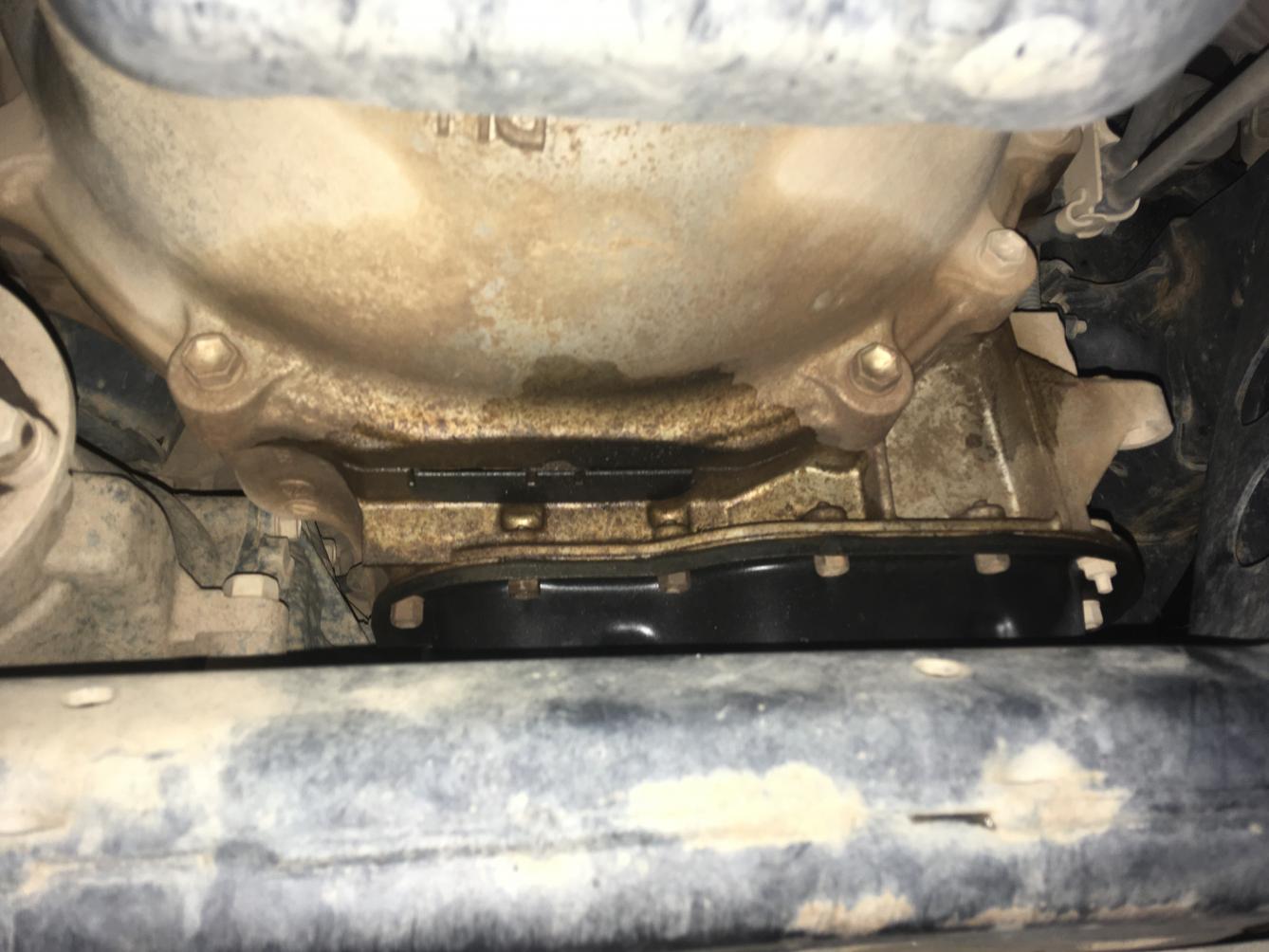

[MENTION=44305]weeeee[/MENTION] looks like my 4runner has joined the club [emoji2359] 52k, not sure how long it’s been leaking.

Ouch. At least yours looks like it was caught before it became a major issue judging by the level of wet oil- not that that is a proper gauge by any means. Sucks that this is happening on such a routine basis on relatively low mileage vehicles.

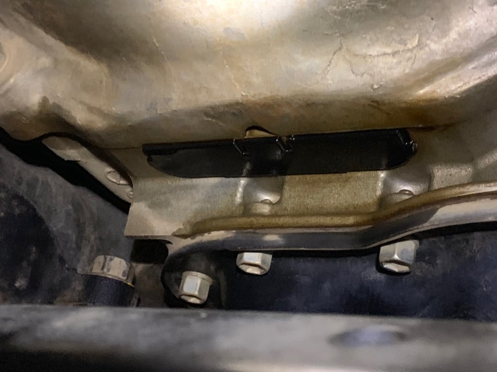

I cleaned off the oil and drove about 50 miles and this is how much has built up. Might be worse than this picture looks. Now I have to go to the dealer. Wish me luck.

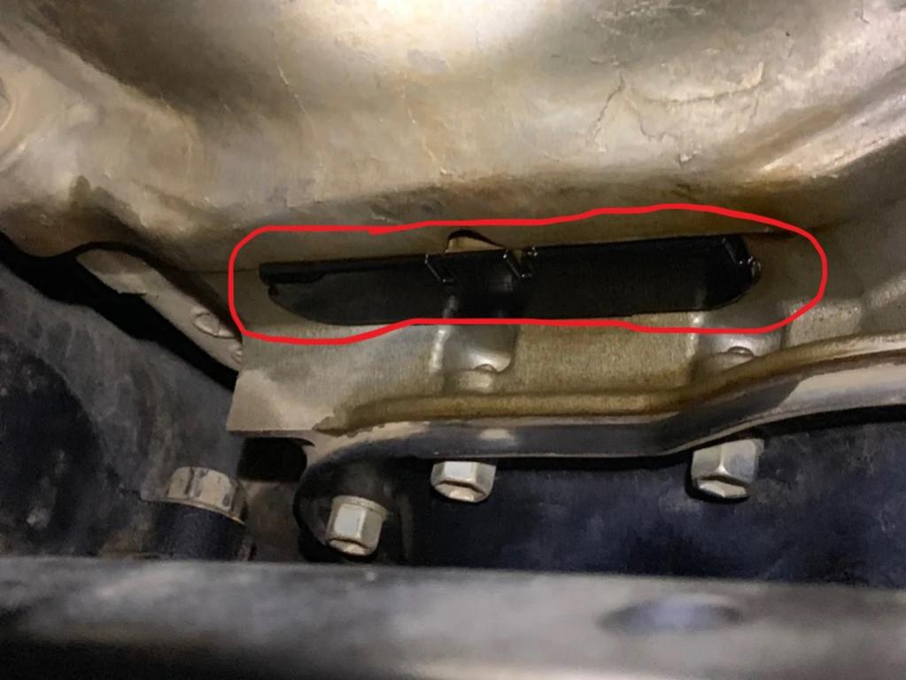

Why Replace Seal?
I circled a black plastic cover-plate on the bell housing in this image. Dust embedded in the damp metal surface below the cover-plate tells me there is no leak, only a negligible seep. Why would one consider replacing the seal when it isn't leaking and streaking? This appears to be similar to shock absorber misting, which is considered to be normal. What am I missing here? Obvious dripping warrants careful oil level monitoring because a torn seal can become a major leak quickly. If it costs $1100 to replace the seal, then speaking for myself, a leak would have to affect engine oil level before I considered replacing the seal. A drip pan is far cheaper. Would it be annoying? Yes, but my 20 year old Nissan Maxima had an occasional drip seal leak which stopped after awhile without doing anything about it except monitoring as needed and checking for a clogged or blocked PCV system.

A lot of the pictures you guys have sent on this post are definitely not “leaks “ and taken to Toyota or a dealership you will find it hard to be relaxed under any sort of warranty as they will just say it’s not leaking it is “sweating “ ... this doesn’t seem abnormal and definitely doesn’t warrant the $1100 price tag.
