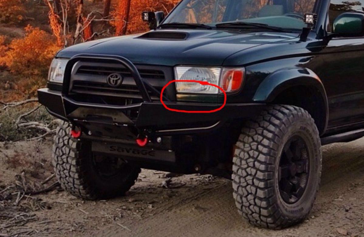

Directly under the headlights there is a 10" X 1.75" metal piece that looks easily removed and would leave a nice gap about the size of a small LED bar. Just curious if anyone has used this spot before, I think I have seen it done but can't remember where I saw a pic of it.
I really like the clean look of the bumper and would rather not add clutter to it so the idea of a light bar on each side that could be mounted flush with the headlights is kind of interesting. The flat portion of the bumper extends under that area so a solid mounting surface is already there.

I thought about making an led bar that would fit in those spots, however, it doesnt really flow well with the headlights, so I didnt end up making it.

That's what I was wondering about, but it seems like a perfect spot for a 10" bar so hoping to find a pic or two to see how it looks.
Thanks! I really like the lights [MENTION=43196]4runit[/MENTION] did below the projectors. However I want something brighter than DRL's so I wonder if they do that same size with high lumen bulbs. Now that I see yours I'm definitely looking at that location as well - looks sharp.
[MENTION=89594]gmv4k[/MENTION] - please let me know if you see anything promising, those ebay lights look like the right size, but says its DRL too and wonder how bright they are.
In preparation for a front bumper build, I'll be putting my turn signals in that spot. I'll be using LEDs and probably some white polycarbonate to diffuse the light more solidly over just a bunch of LEDs. Been working on this off and on for awhile so when I make some meaningful progress I'll start my own thread.

Very nice! i just marked where the light's where on mine and drilled the holes, then cleaned up the edges with a Dremel.

it looks like they don't sell them anymore... just take the metal strip under the headlight off (1 bolt) after removing the grille, mark where the lights are, drilled the holes (slowly and gently!) then clean up the edges if you want. Some put the lights on a separate switch, but i've got enough switches, and they draw so little power a relay is pointless.
