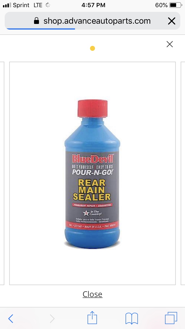

Use it one time let it cycle through. Only put one 8 oz bottle of treatment in with the motor off. After start her up and drive.... you will notice after 200 miles that POOF it’s gone no more leak.... and it works for up to 10 yrs or something like that. I used it on my 95 4 runner.... and I have not seen any oil leak from the rear main.... now I only have minor leaks coming from the valve covers[emoji122][emoji1360]
