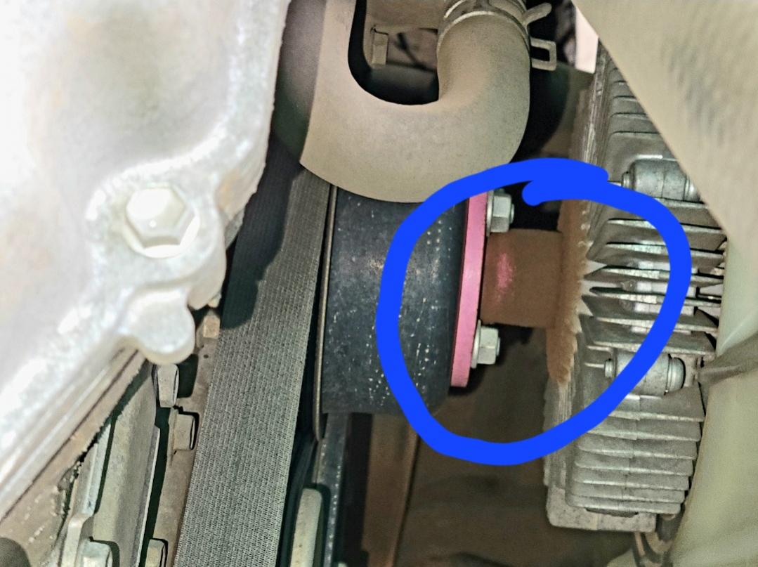

How bad is this, it works fine, no noises
Not sure what we're suppose to be looking at....BUT if all the oil leaks out you may not hear any noises, usually the main issue would be the engine not cooling properly, so keep a watch on the temperature gauge, if it goes even a little over "normal" I would stop driving and let it cool off, if you let the temperature go anywhere close to the maximum temperature on the gauge trying to drive a little bit further you could risk major damage to the engine.

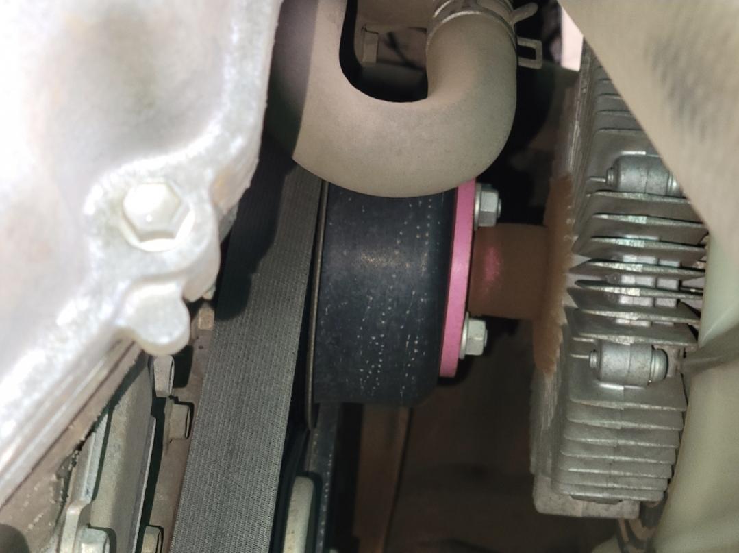

Sorry highlighted area weeping
I guessed that's what you wanted us to see, but it still doesn't tell us how bad the clutch is, it may still have plenty of oil in it and will work fine...for now...but when enough oil leaks out....then the rest of my prior reply is what advice I would give....other than to just replace it and not worry about it any longer, which you're going to have to do at some point and I would do it sooner than later.
The point I'm trying to make is it's worth spending a few bucks replacing it now than to have to spend a LOT of money later to replace or do major repairs to the engine.
Any leakage is bad. The clutch has a specific amount of silicone inside to function properly. And now its failed. This is the only thing keeping your engine cool. Whats it worth to you? $100 now or $8,000 later. You dont want to be upside down on this trade.

The purpose of forums is to get differing views to make a right decision, you clearly misread my thread and am not closing it.
