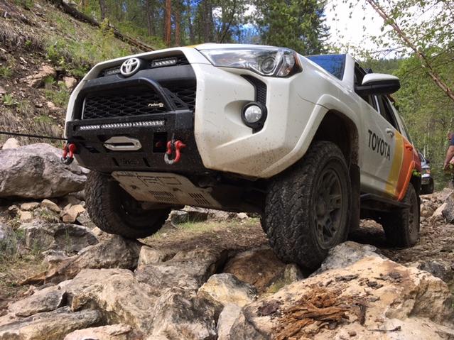

I get "stuck" all the time without lockers. Where I really wish I had it is when you are "teadertotting" on 1 rear wheel and 1 front wheel, Atrac is not enough in those situations, which I seem to find myself in a lot. Another reason I wish I had them is when you are stuffed against something and you need to crawl up over it...depending on how the vehicle is situated you are usually trying to push a dead wheel up over that obstacle.
I am one who very much wishes I would have just paid out that premium for the mechanical diff and the rear locker :(
Have nothing to add other than I love the old school graphics on your truck.
Carry on.
