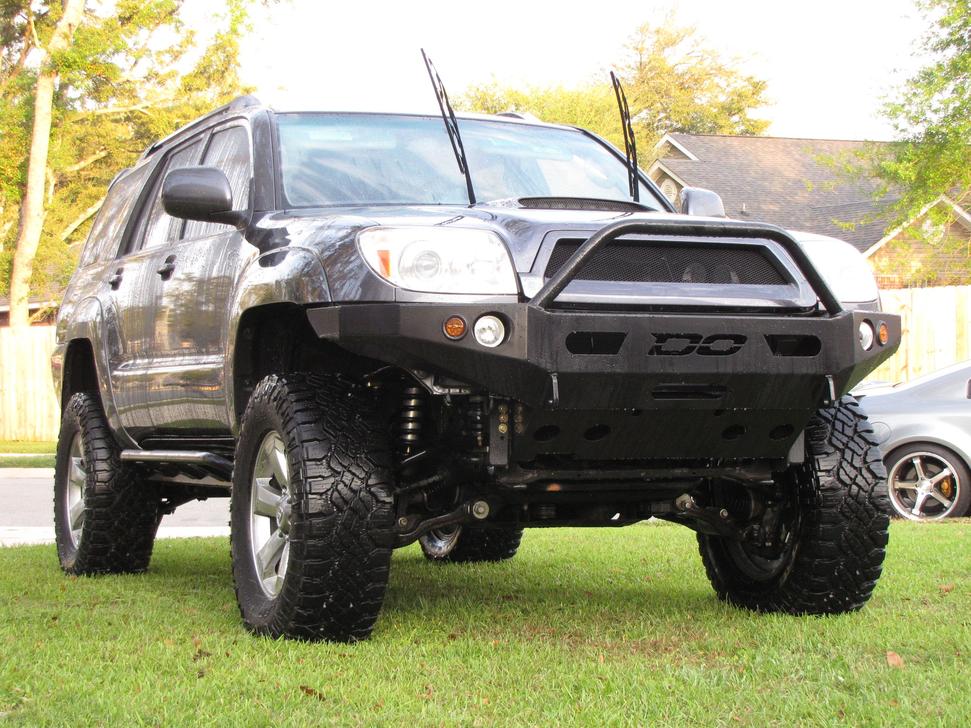

Yea, here is a good tire profile shot. 295/65/18 with spidertraxx spacers and LR UCA
As for gas mileage, I'm probably the wrong person to ask... V8 supercharged, 33" tires, 3.5+ lift,etc. equals TERRIBLE gas mileage... I'm thinking with a full tank I get 250 per tank (mixed driving)
