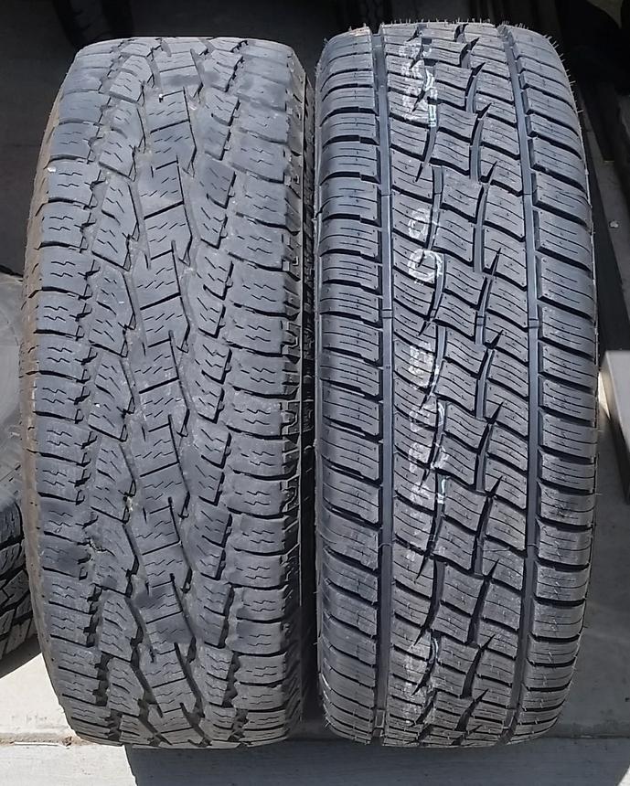

Not all tires are the same... My 275 coopers are wider than my 285 coopers. My 275/60/20 tires on Limited 20" wheels do not fit without spacers with the JBA UCAs. My 285/75/17's on Trail wheels do fit without rubbing. I modified the UCA's slightly to make either fit with or without spacers by cutting a small amount of material off where it rubs. So this will depend on your wheels and your tires some. I think most 285's on OEM 17" wheels should fit just fine.
285/70/17 - 285-75-17 - 275/60/20 (yeah, the Toyo AT2's run a bit on the small side, the AT3's are a bit narrow and/or the HT-Plus are a bit wider than spec.)
Toyo AT2 285/70/17 vs Cooper HT Plus 275/60/20

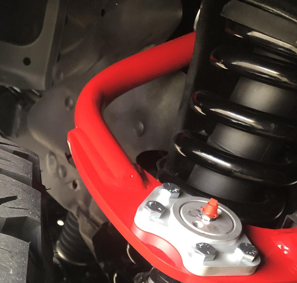

I had Discount tire order 285 Wildpeaks as well, and I’m going to test fit them and the KO2s to see where I rub. Here is my clearance with KO2 275s:
I think I’m going to be ok

JBA are very dependent on the backspace of your wheel. They have a pretty wide fin on them. Also his recommendation for wheel backspace to ensure clearance on his site. I have JBA and no gripes.
