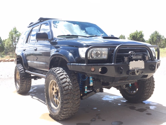

So, if I read correctly, you did little to no trimming with 2.5” lift in front and 3” in rear?
This is what I've needed to trim out of the firewall area:
When I had my stock bumper I had to trim away the inside corner of the flare as well.
In the rear when I had the flares/mudflaps I used to have a slight rubbing issue on those (especially on the screws that poked out).
I can't tell you how much "lift" I have (I don't know what my stock height was, I haven't measured, and I really don't care) but I can tell you a lift does not help with tire clearance. Lifts only changes the ride height and do not change the geometry of your suspension travel - so whether you have a 3" lift or are at stock height, full bump/flex/lock doesn't change where your tire is at.
