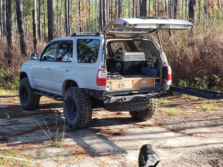

Sorry. To be clear, I have 8" wheels with 4" BS, and with my tires puts me about 1.4" further out than stock on each side. You will be a hair further.
After substantially softening up the suspension, I rub still on the back of the fender well on the driver side and on the left side frame at full lock. Also, occasionally I rub the passenger side front of the wheel well where where the windshield washer fluid reservoir makes the wheel-well trim stick out a bit more.

I mispoke before! My wheels have 4.5" of backspacing! But, the edge of the rim sticks out about 1.25" further than stock, and the edge of the tire is about 1.5" further out than stock. So, 8.5" wheels with 4.3" if backspace would stick out another .7" beyond what is pictured!!
I only add that correction because it will affect both the aesthetics as well as the amount of trimming required (more trimming!).

Heh, if x8 with 4.5" BS is "correctly spec'ed," then I guess I got the short end of the stick because even with my previous ~3.25" lift on a hotwheels-stiff front end I rubbed a bit on the back of the flares until I trimmed a bit, and this was just during daily driving. It rubbed a bit more during offroading, but I never flexed it much (mostly due to its stiffness, but also due to the moderate forest roads I was doing). With my softer front end and more aggressive offroading lately, I rub quite a bit more, mostly at the rear. Increasing caster by moving the upper joint rearwards would only exacerbate this problem except where I occasionally now rub the front passenger side at the coolant bottle bulge.
But yeah, I cannot imagine a way that a 33" tire could move through its entire articulation and turning arc on a flared 3rd gen without any rubbing. Are you sure the anecdotes you found weren't in reference to flareless rigs, or only in street driving?
Oh, I actually have about .5" between my sidewall and UCA, rubbing 285s on 16x8s with 4.5" backspace. A 315 adds 15mm, or about .6", to each side of the tire, so I would rub the [stock] UCAs with these wheels and 35s. However, 4.25 to 4" backspacing should work. Of course, that means more "persuasion," even with 33s.
