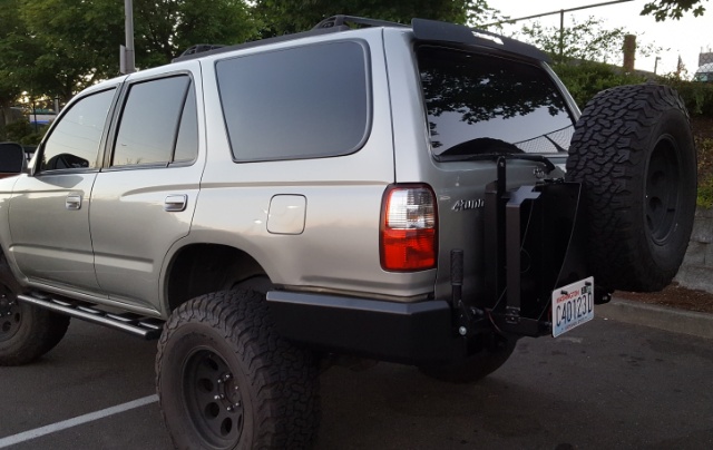

I have the innovations rear
http://i.imgur.com/PogUuJY.jpg

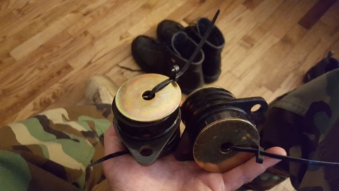

I did replace all of my old body mounts with new Toyota body mounts. I also added a couple of flat washers between the bumper and the frame where each bolt holds the bumper to the frame.
when I compared the old rear body mounts to the new ones, the old ones had compressed 1/4" or so over the last 17 years of service.
I did have trouble with the rear fender pinch welds hitting the new bumper when I was off road, replacing the body mounts with new stock and adding the flat washer has fixed that issue.
