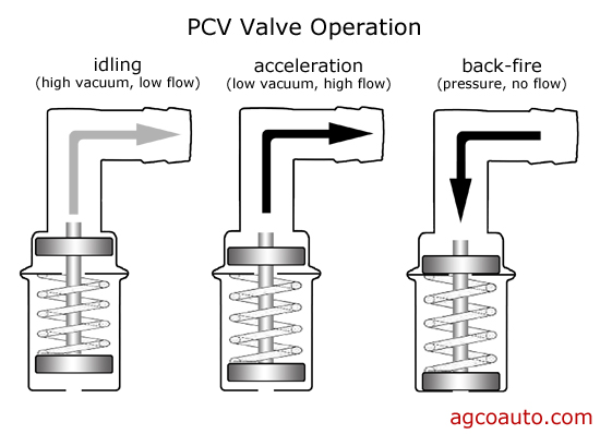

I think I found the answer:
Any pressure in the intake causes flow in the opposite direction. This could occur during an engine backfire or if the engine is turbo-charged. The PCV valve can act as a check-valve in these situations. By closing the PCV valve, any positive pressure or fuel vapor is prevented from entering the crankcase. Even a very small amount of positive pressure can force oil passed gaskets and seals and blow gaskets out of place. Failure of the valve to seal positive pressure may damage the engine.
What happens if I remove the catch can????
