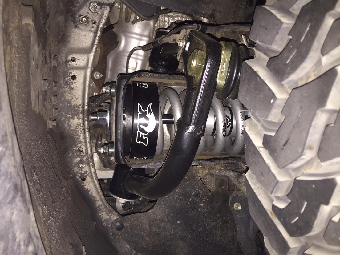

Finally got it done today. FYI do not leave the daystar spacers in on top of the new coil overs. We thought we would try something different by leaving them in and dialing down the Fox shocks in hopes of a better ride. Side by side the Fox and OEM shocks look about the same height but the compression in the coil must have been the kicker because the control arms rubbed at full extension.

Never use spacers on top of the top shock mount, ever. When you reach full compression, you will bottom out and destroy your shock before reaching the suspension bump stop.
