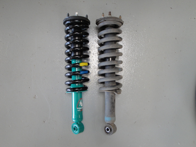

I installed the SS 3.0 system last month on my 97 4WD. I gained 3/4" in the front and only 1/4" in the rear. I'm very happy with the front. It rides much better with the new TrekMasters and 99 model springs. I'm hoping the modest lift won't impact the longevity of my CV joints and boots. :driving:
Here are my stock and SS 3.0 front shocks/springs.
In the rear I notice better damping with the new shocks, but the springs are essentially the same as I was running before...Toyota must have put 99 model springs (or something close) in it when I did the factory recall years ago. I'm considering different springs/shocks for the rear since I ride around with a 100 lb subwoofer box in the back and the kids are getting heavier every month. Looks great when nothing's in it, but the rear leaves something to be desired when it's loaded down. :ybrick:

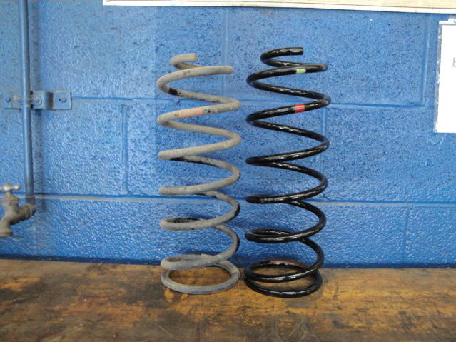

Here are my stock and SS 3.0 rear springs. After the new ones have been compressed for 10 years, they'll probably look just like my old ones...but I won't wait that long to upgrade the rear again.

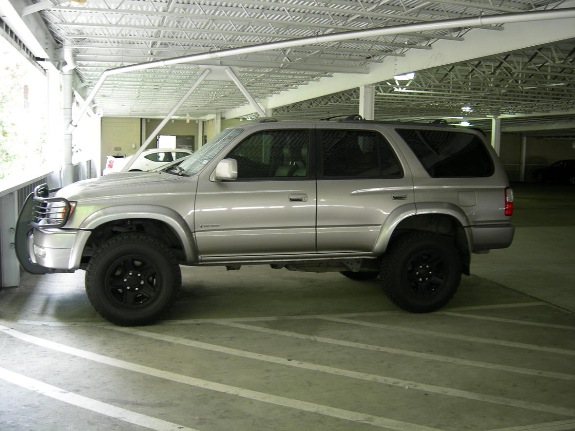

Here is my rig after the 3.0 install. Not too shabby, but another full inch of lift at the rear is what I need to make it look and ride better.

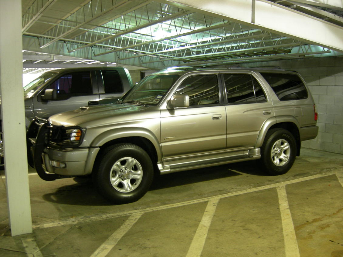

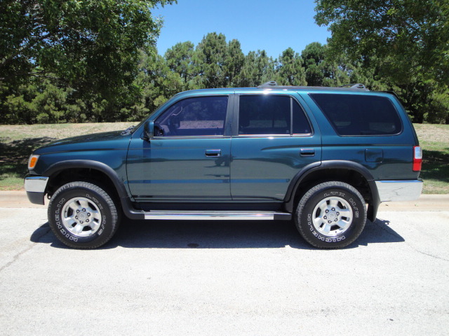

Here's before and after pics. Before is completely stock except for the grille guard. Then I added SS 3.0, 265/75 tires, and removed the running boards.
Qyota, if you're looking for a higher rear end, mine has a slight rake. The 3.0 kit for 2wd comes with rubber spacers about 2" thick to go on the rear springs. The place where I had the lift installed forgot to put those on, so the truck looked like it was sagging. I took it back to have them fix it, and now the rear sits slightly higher.

Cool, thanks for the pics. Great looking ride, same color as mine. I work right by Reliant Stadium on Holly Hall but live in Kingwood (59 North)
EDIT: Looking at the pics again your lift sure looks a ton higher than Cajuns' even though you guys have the same setup I believe??
Would the front suspension from System 3.0 look good with OME 891's? Or would that be too much of a rake? I don't see how that would be too bad of a setup personally. You would have about 2 inches of rake in the rear at most right?
Anybody have that as a setup?
I think it looks like that mainly because Cajun still has running boards on.
Yep, that and I'm still riding on P265/70s.

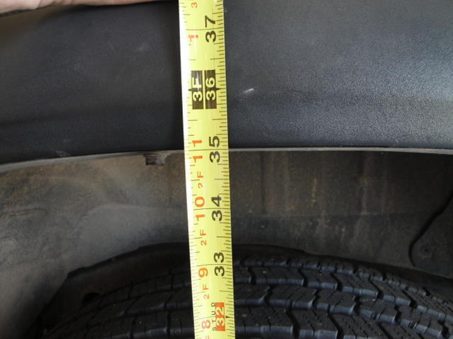

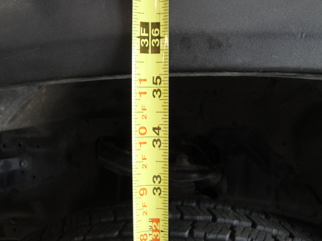

With SS 3.0, ground to front fender flare = 35 1/4"
With SS 3.0, ground to rear fender flare = 35"
