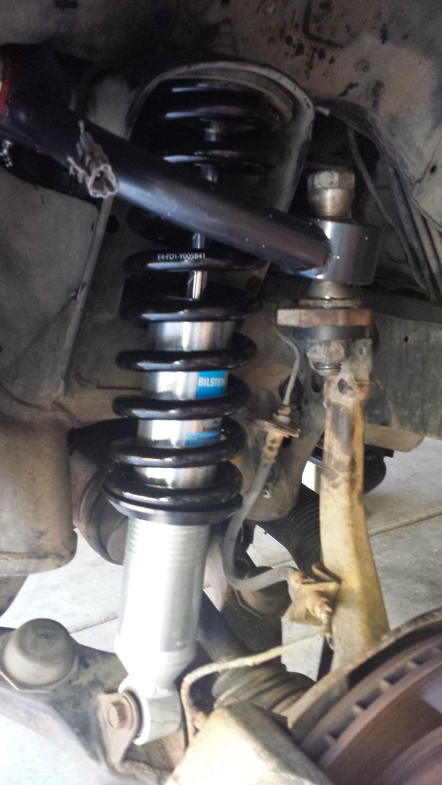

Just installed on my buddy's 97 SR5 4x4. Can't see the part # in the pic but I assure you these are the new 3rd gen 6112s, PN 47-258624. They do exist!
Are those a different shock than in the previous post? because they sure look different. What are all those grooves below the spring support?
Grooves are for the different lift heights. Depending on the circlip setting, you can get anywhere from 0-2.3" lift. I believe each groove will increase/decrease the lift by approx 10mm.
Yes these are the 60mm ID 6112s that were just released on the Bilstein online catalog.
