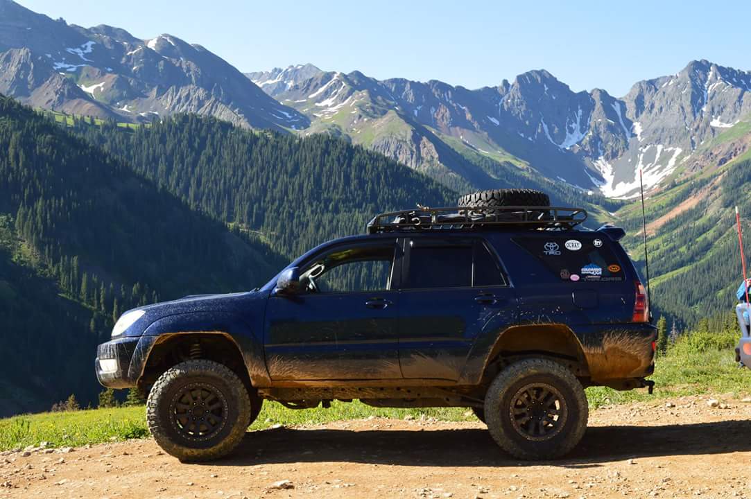

toytec BOSS 3" with 3/4' topout spacers and superflex HD rear coils

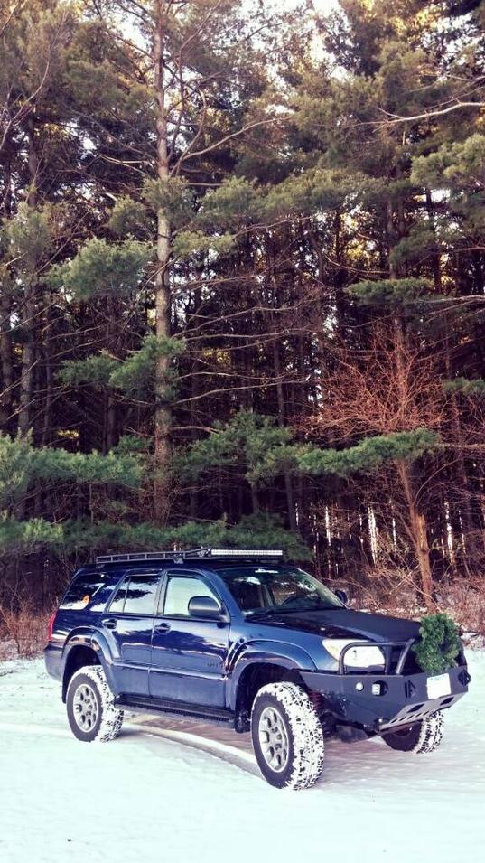

I just run a standard toytec supension setup with adj. front-coilover setup no spacers, and have toytec rear stiffened springs on Icon shocks.
