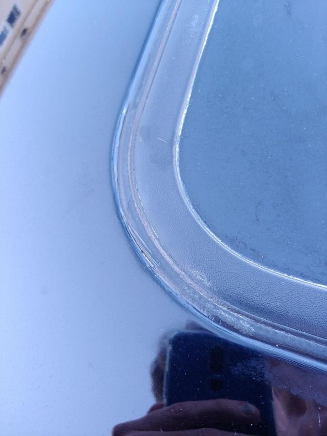

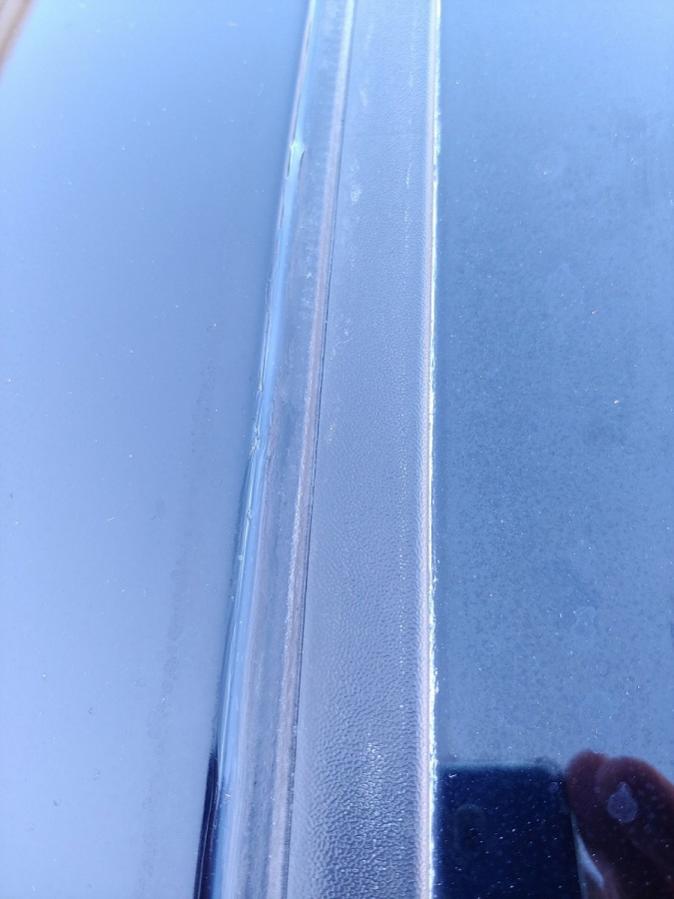

Recently I noticed I had a lot of moldy smell in the back of my 4Runner and after tearing out the carpeting I discovered the sunroof had been leaking into the cieling and dripping out of the rear hatch light assembly. I also had a leak from the driver's side rearmost window due to a bad seal.
So anyways I cleaned up the mold washed all my carpet with detergent and let the truck dry out for a few days. Then I sealed up the window and I taped off the sunroof with blue painters tape very carefully before sealing that up as well. I used silicone to seal the gap and was very careful to cover all the inside rubber and painted metal with the blue painters tape before applying the silicone. In all it was quite easy.
Sealing both of these was hardly a great solution, especially the rear window but it seems to have worked. In the case of the sunroof I can easily remove it the seal if I want to use the sunroof properly at some point down the road. For anyone considering this I highly suggest you use clear silicone, not window sealant. I also suggest you clean and wax the painted areas before doing it so that just in case any silicone does touch the paint you can easily wipe if off.
Lastly, I am pretty sure a major reason why I have this problem is because years ago my sunroof drip tray (inside the sunroof) separated and came loose floating around detacted inside my sunroof. I didn't have any simple way or reattaching it without taking everything apart so there was nothing I could do but remove it.

I figure it is possible this happened to others here, perhaps even before you bought the truck. In my case with the drip tray missing any water leaks through the roof and out the back ceiling light causing mold. Sealing it with silicone is definitely not a proper fix but at least it looks clean, works and is fully reversible.
