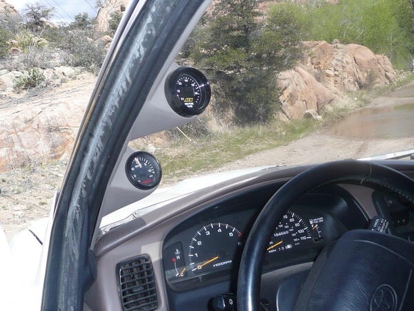

Here's the Oak color Lotek, it's a good fit. We did Dremel it, only because we are anal about making it look OEM. The color match is right on.
Btw.... The pillar grab handle will not align correctly above the driver side door, it's not shaped for that purpose. However, we sourced a overhead passenger side grab handle from someone parting out a runner. As mentioned the threaded holes are already in the driver side location. FYI, make sure to get the screws along with the grab handle.
Hope this helps...... Regards 8sm

Looks good! Could you throw up a picture or two from the inside? Id like to see the seam you cut for the factory look. Is it possible to install over the existing a pillar or does it have to be cut out?
You'll need to remove the existing pillar to install the Lotek pod. If you decide to purchase the Lotek pod, you will see that the fit is actually good with very little tweeting required. Remember, measure multiple times and cut once should you feel it needs it.
The posted photo is from a file i have on the 4runner. I'm not in the same city where it is kept to get you additional photos anytime soon. Sorry

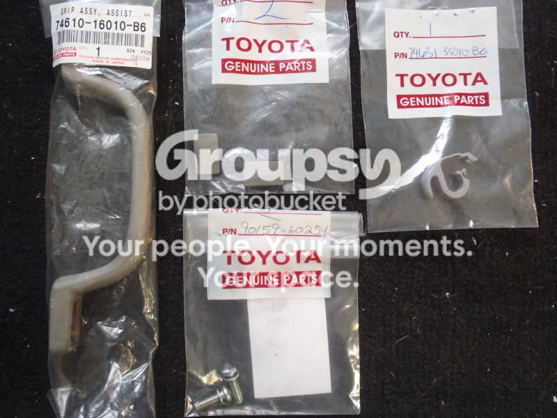

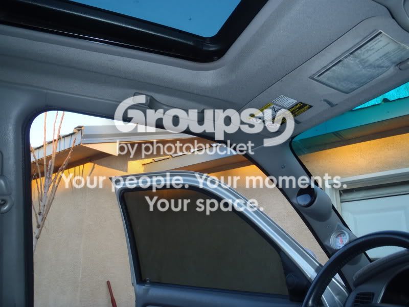

That's why you add one of these.... The holes are there under the headliner, and they are threaded from the factory. You just need an extra handle/bolts/bolt covers... they are identical to the parts used above the D/S rear door.
**note guage pod installed OVER factory trim
