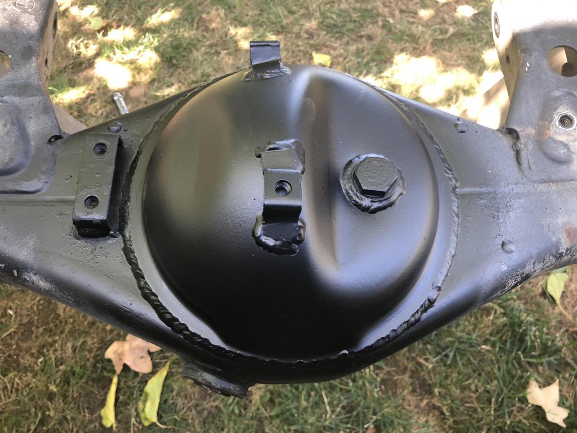

I welded one on yesterday. I was a little apprehensive ordering it considering the brand is Dorman but it ended up being little beefier than the stock cover. You will definitely want to remove your diff before cutting/ welding and probably remove your axle housing unless you have a lift to work under.
So the Dorman covers clear the lateral control arm. Great to know.. :)
