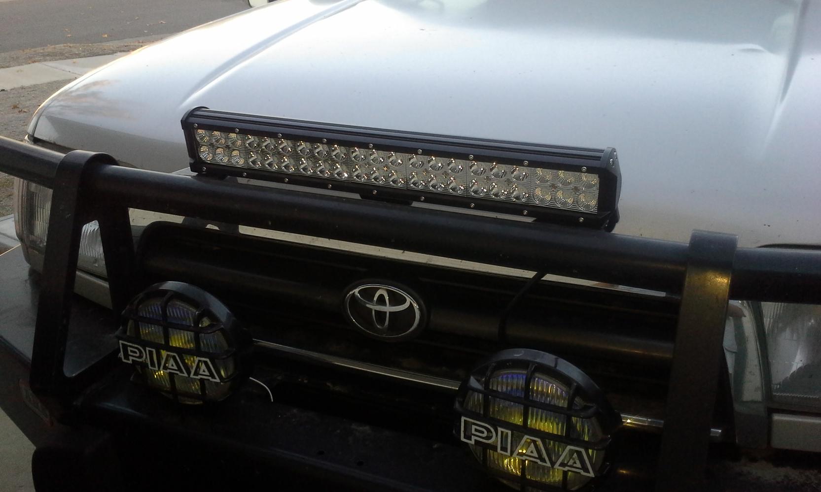

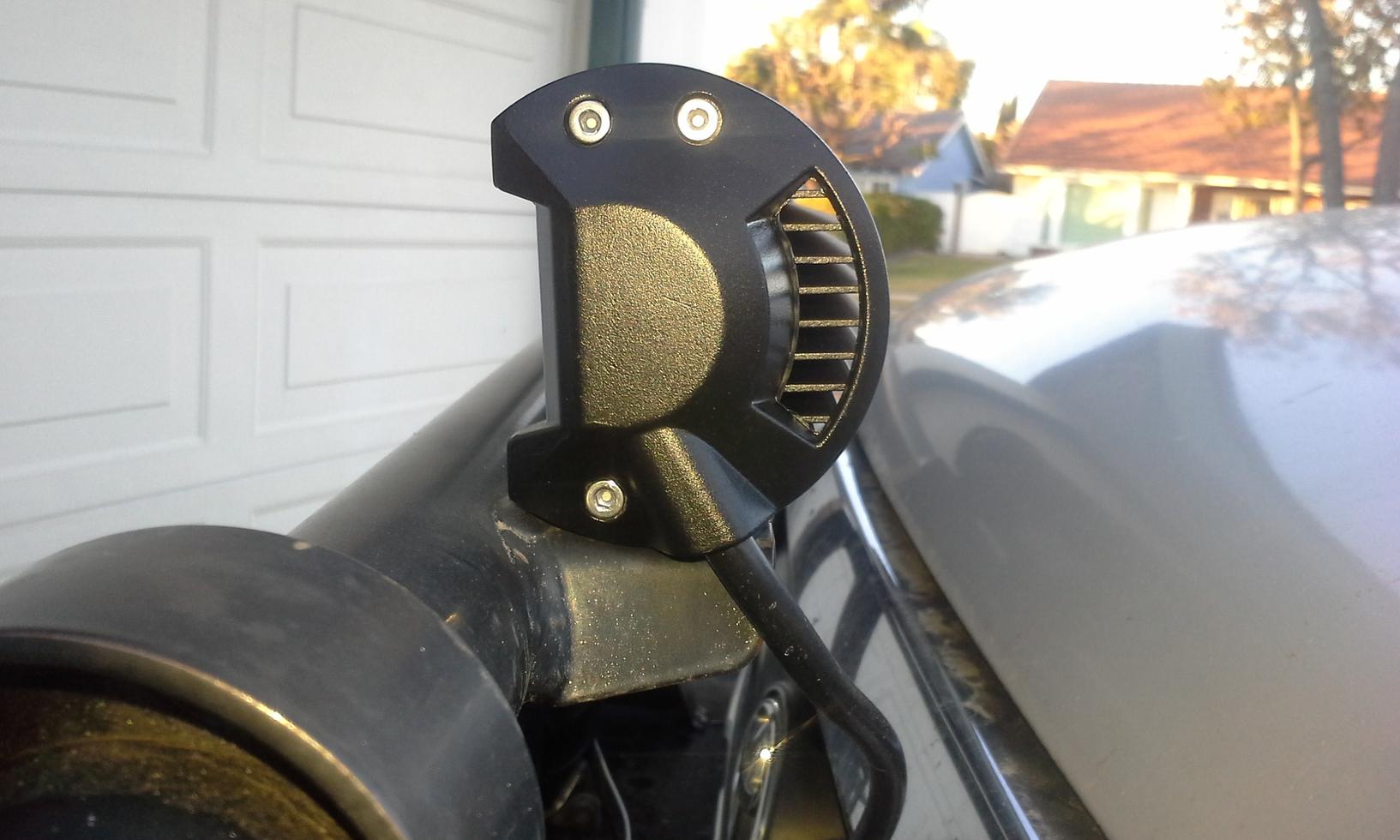

[MENTION=89791]preacher35[/MENTION] [MENTION=113611]m85476585[/MENTION] Well, I received it yesterday. First impressions, I like it! Looks like its well built. Its a bit on the heavy side. Maybe it has some heavy duty parts. Might be a winner. Still need to wire it up.

Make sure you seal up any openings that will cause condensation. That's the number one problem with cheap bars. Otherwise they're bright as hell.
Silicone?
Yeah, clear silicone would do it. I've got this stuff called amazing goop that I've used on a lot of things (including my projector retrofit). It dries pretty quick and holds up well to heat.
I'm super stoked to hear how this light bar works cuz I've got my eye on this 42" one from Amazon for like a hundred bucks!
This particular light bar looks water tight. Supposedly its rated IP67 which is good for 1 meter under water and totally protected against dust. I'll give a full review after this weekend when I'll be wiring it up.

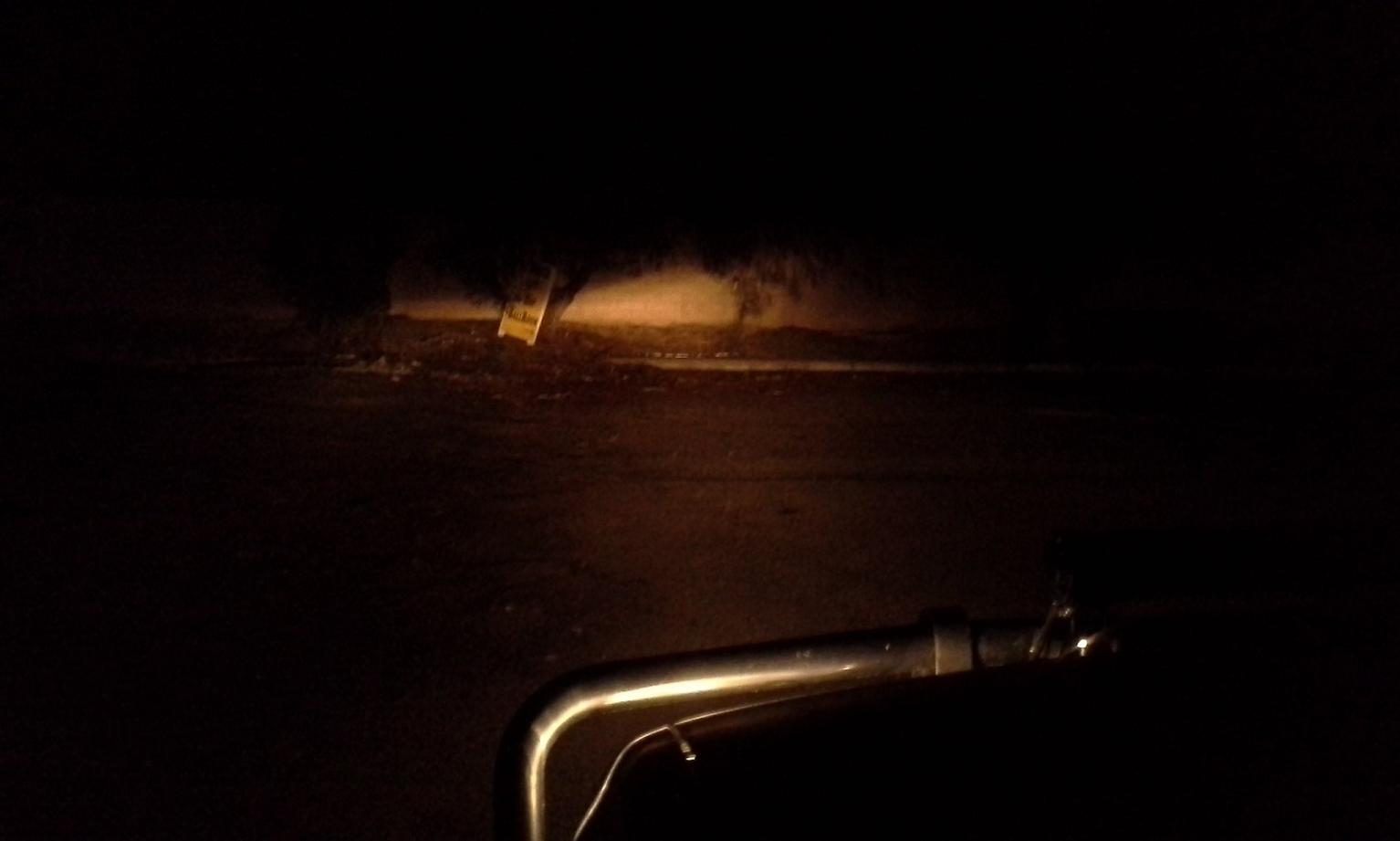

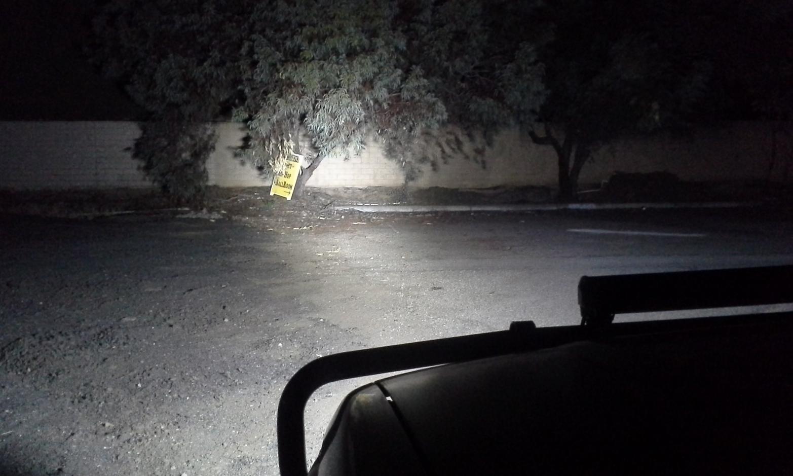

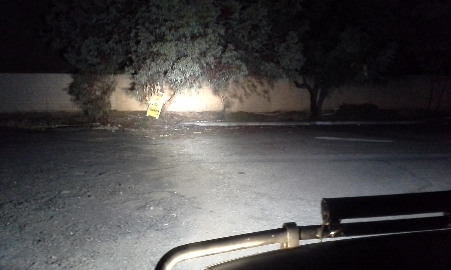

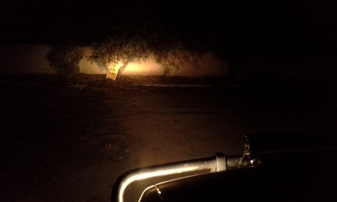

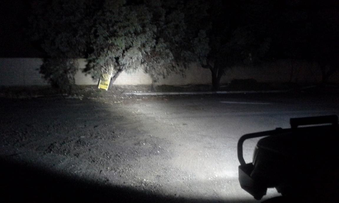

Best $40 light upgrade I ever spent! Not the best photo cell phone camera ever, but even thru a cheesy camera you can see the difference. Very satisfied with the LED Light Bar. Next up date is too see how long this thing last.
Low Beam
High Beam
LED Bar Only
LED and High Beam

[MENTION=123332]Drunner97[/MENTION] Not only does the light projects far this spread isn't bad either. Its a good buy.
