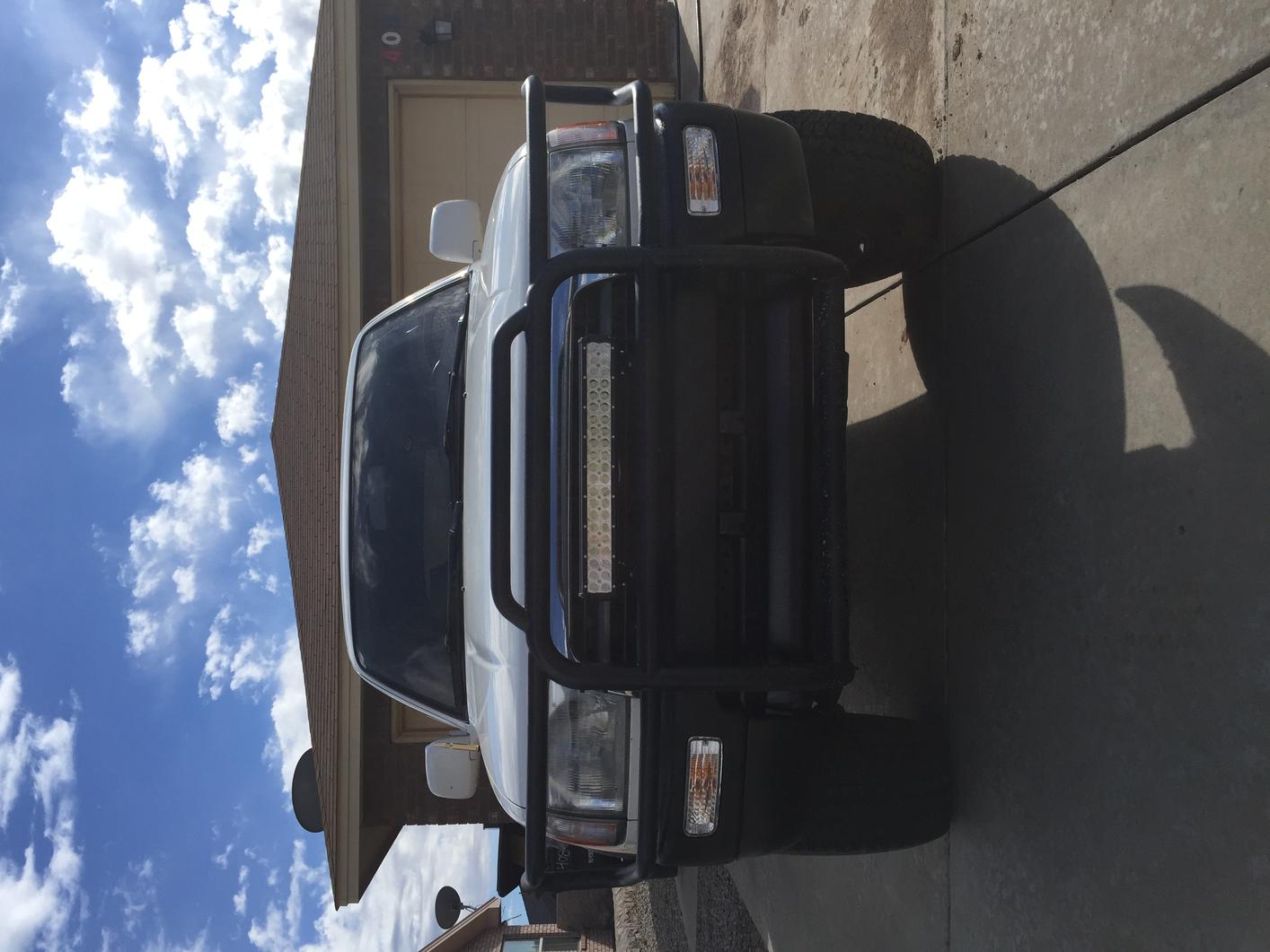

Thanks for the recommendations. The previous owner only had a fuse, no relay. I ended up ripping his stuff out and replacing wiring. It now works great without any issues. Sorry about the delay in the update, I was waiting to finish bed lining the grill guard and bumper before putting the light back on.

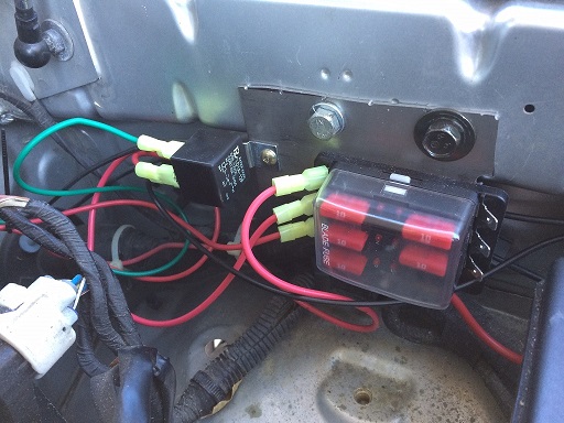

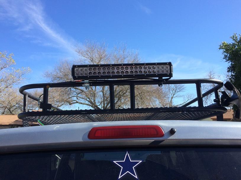

I purchased two. One for the back, mounted on my rack, the other for the front. Still need to build the front mount.

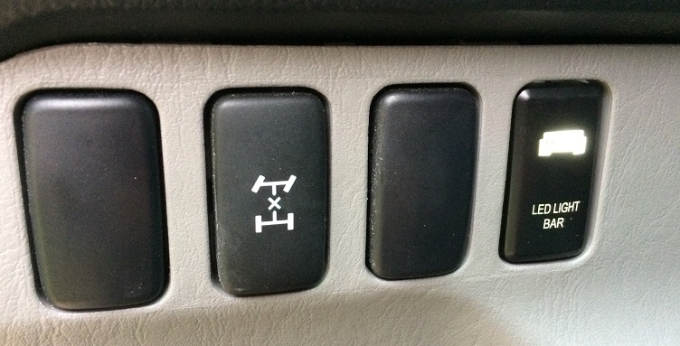

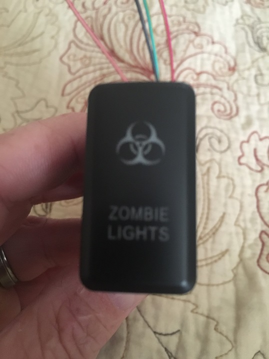

Where did you get that factory looking switch for the dash?? looks great. I just ordered a bar and plan on adding one on the back somewhere as well. Do I need to order a second wiring kit (relay, fuse, and switch) from amazon or can I just add more wire and a second switch from radioshack to the first wiring kit?
This is the light bar and switch I just ordered for the front. I'm torn on where to mount a rear one.
https://www.amazon.com/Nilight-Floo...TF8&qid=1474591152&sr=8-1&keywords=nilight+32
https://www.amazon.com/Nilight-Wiri...g_2?ie=UTF8&psc=1&refRID=G5J5F1ST8FEVWSAW0NWK
Just search Mictuning Toyota on amazon. They also have some nice wiring harnesses with multiple relays built in. Makes running everything much easier.
https://www.amazon.com/Mictuning-Sw...d=1474644861&sr=8-3&keywords=Mictuning+toyota

Yes, I have it mounted in front of the radiator (actually, the A/C condensor that is in front of the radiator). No, it did not cause temps to go up, it's just not big enough to affect it. I also have a transmission cooler in front, also did not affect temps.
