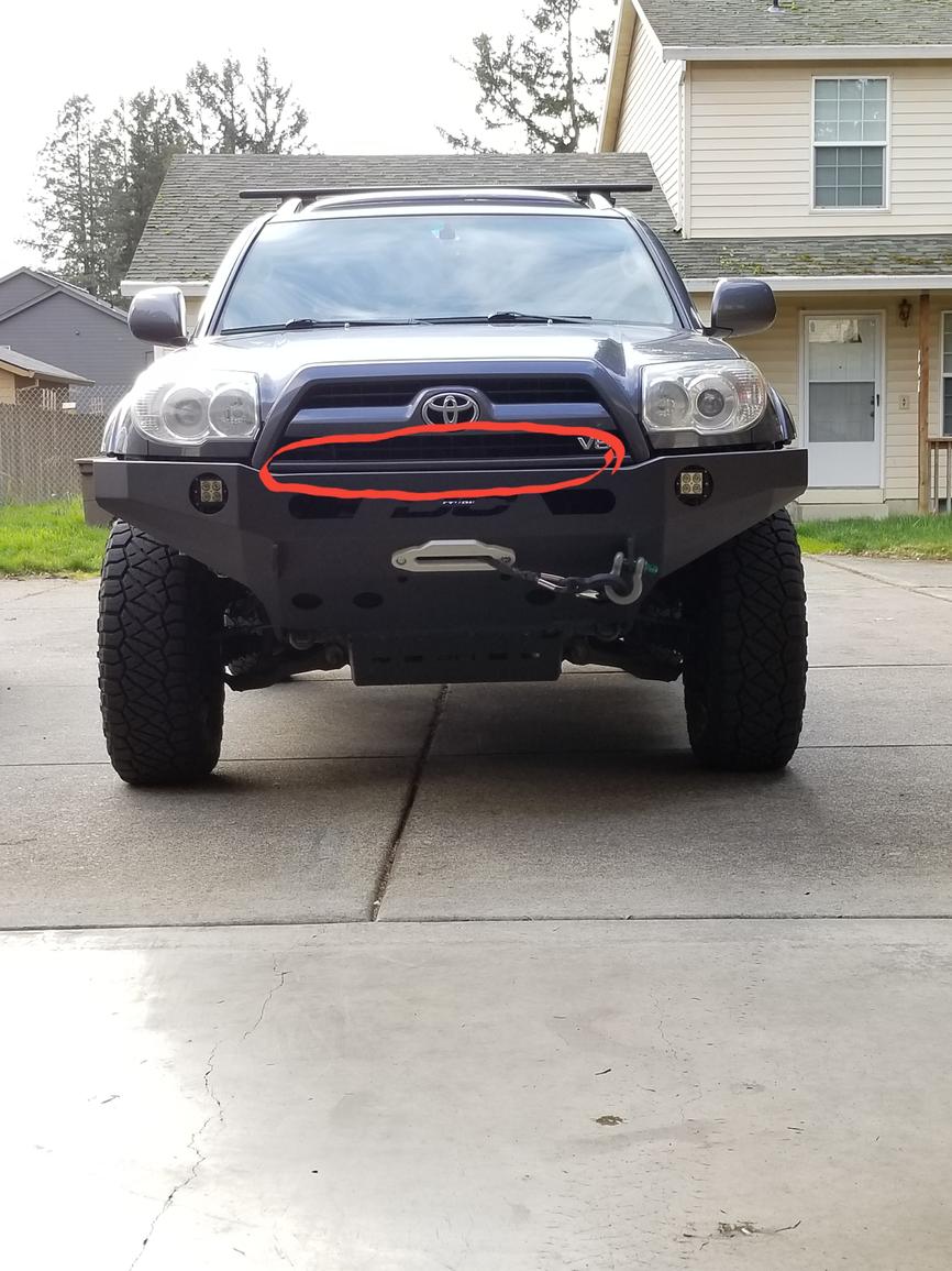

Just installed my Demello bumper. Love it! But want to mount my light bar to it. Anyone mount there's and have pics? There is no cut out for it. I'm thinking of top center with the L brackets, but am hoping someone has done it already. Red circled area in pictire. Hate to drill holes and then not like how it looks.

Why not sit your light bar on there (maybe with some double sided tape if it's not steady) to see if you like how it looks?
I did this and liked it. Think I'm going to do it. I'll start with just a small 1/4" bolt hole to be sure. I'll post pics when done.
Well, good thing I did not drill holes. It does not fit. The hood will not open with it. Need to buy a slimmer one I suppose.

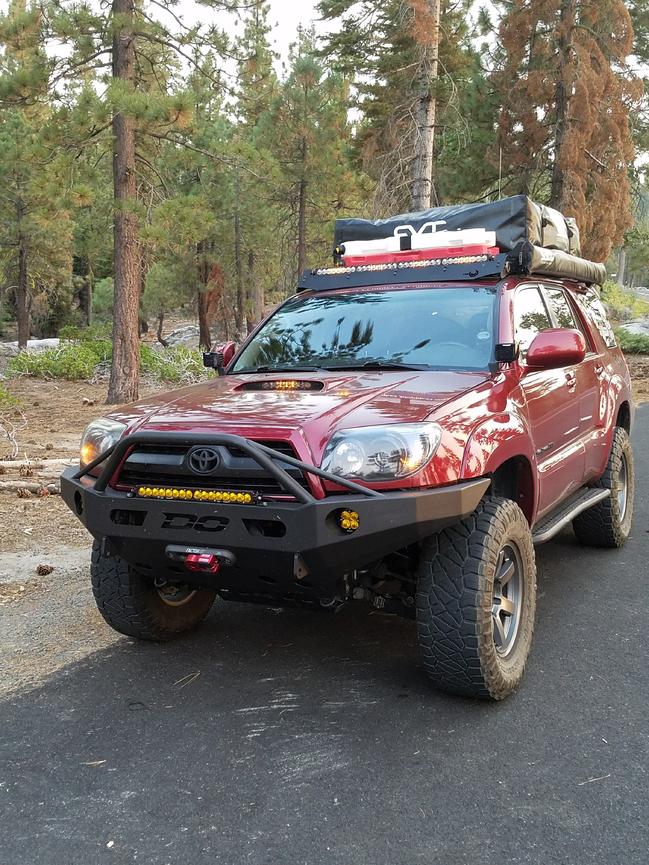

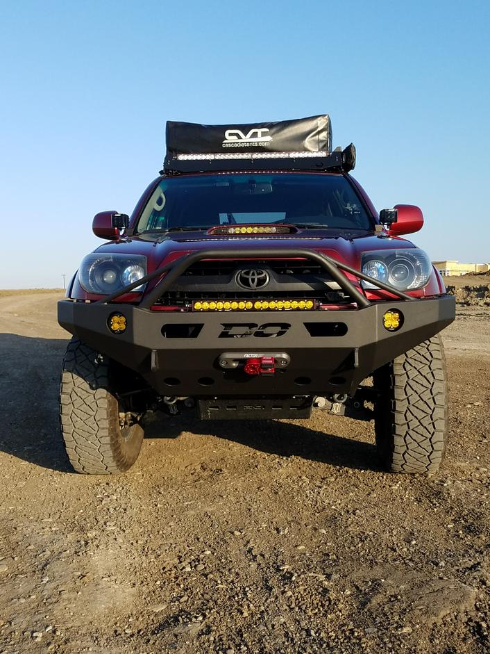

It will work. You just have to move the light as forward as possible. I'm running a Baja Designs 20" in there. With that said you have to either disconnect the hood security latch or what I did was drill a hole in the latch lever you pull with your finger, install a bolt with two nuts and a washer so the washer is sandwiched between the nuts and essentially move the lever up into the grill area. So that way you pull up on the washer and it pulls up the lever.

Yes, from my measurements the BD 20" will fit perfectly. The cheaper Cali Raised I have now is 1/2-3/4" deeper and my hood does not clear by a little less than 1/2"
