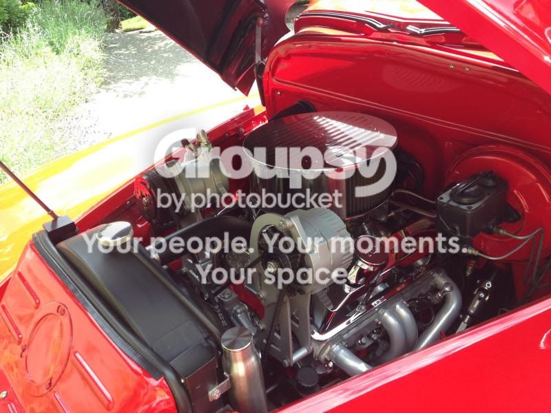

I just recently picked up a restomodded 1948 Chevy convertible. Came with a 383 stroker crate engine. Currently it's setup with two breathers. I know that a lot of people who run this engine run it with one breather and a PCV valve. I will whole heartily admit that I know NOTHING about this engine. Should I change the setup?

Ive seen a lot of small block chevys run with the breathers, and never heard of any reason it was a problem.
If it bothers you, it would be cheap to go to a pcv set-up, but as long as the breather doesnt get clogged and the car is running good, Its probably fine.
The pcv just returns vapors from the crank case into the intake to be re-burned, but as long as the vapors can escape, its not hurting the motor, I think it just lowers emissions

Yep, breathers just vent the crankcase vapor to the atmosphere. PCV systems were invented to eliminate that source of pollution.
Since the number of street legal cars like the OP's are miniscule in comparison to the number of modern emissions cars on the road, and the fact that classic cars aren't driven that much anyway, I'd just leave it alone and enjoy it.

Thanks for the two cents, but I actually like the carbs. Nice and simple.
As others have said, forgo the PCV valve.

You can run the PCV and it won't hurt anything. The minute amount of performance you might give up won't be noticed.
I run a PCV valve in my 68 Firebird. The car has a 400 with Ram Air heads and a Crower cam. The motor's pushing out just over 425HP and it has a PCV valve.

But the amount of pollution it would clean up is also insignificant on a rarely driven, carbureted, gas tank venting to the atmosphere, non-catalytic convertor equipped classic car.
I wouldn't install a PCV system, just because it would clutter up the look of the engine.

I ran a PCV and breather on my truck with a 357 (350 that's 40 over) and my dad runs both breathers in his chevelle with a 355 (350 punched out 30 over), I just ran the PCV on mine because the builder told me to. I honestly did not like it because I felt that my vacuum was always inconsistent and I was always messing with the idle mixture screws and fast ide control trying to dial it in with proper vacuum and the chevelle was always dead nuts consistent no vacuum leaks or inconsistencies and always ran a solid 11.5 in/Hg at idle even with a massive cam. My motor was the same but 40 over with same heads, similar cam, same vacuum advance dizzy, everything but always had tuning issues.
