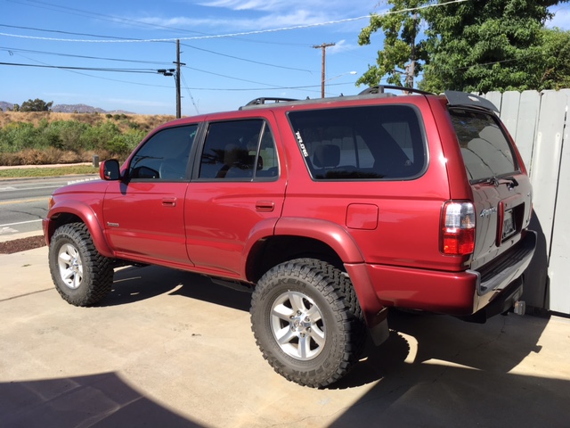

Here is a pic of mine with OME 906 rear, 99 talls front, 265/75 r16 tires
Lots of us are running a 2" lift. Looks good with 265/75/16 sized tires.
If you are not into hard core off roading, this setup will take you deep into the woods no problem....
