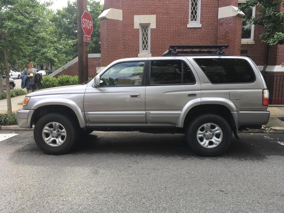

So I'm looking under my truck today and see I have Bilstein shocks? I thought it was all stock when I bought it. Do I already have a lift on this truck? Here's some pics of the front and back. and what it looks like now.
Those are Bilstein 4600 shocks, which are a 'stock-type' replacement. Your truck looks like it is at a stock 2000 height.
When measuring height of the truck, measure from the center of the wheel hub to the fender. That removes tire size as a variable. Around 20" is considered 'stock' ('99 talls sit around 21", early and late sit 19-20", depending). My '99 2WD (not a '99 tall truck..) was just over 20" all around when it was stock.

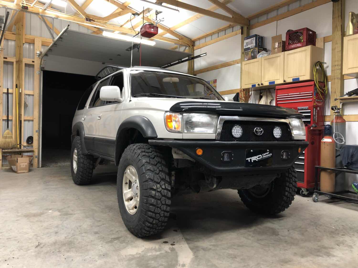

2" ome coils w/ 255/85/16s. Took a bit of work inside the fender wells to make everything clear when its flexed.

Haha I’m guessing “bit of work” means hammering it with a BFH?
I love the look. How’s the power with those tires? Did you take an MPG hit?
Hahaha yes, a 3# hammer helps quite a bit. From 265/75s to 255/85 I did notice a bit of power loss. It's not terrible though.
Thanks, I love the look so far, just hope it doesn't rip any fender flares off on the trails. I just switched last week after ruining a sidewall on my wildpeaks. It's not my dd so I haven't put many miles on them yet. Based off of the power loss Im thinking it lost some fuel economy as well.
