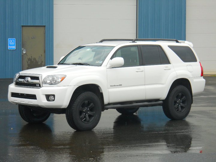

I just finished lifting and putting tires on my 2007 sport. I installed the same lift with 1.25" spacers, Airlift 1000 airbags and Goodyear 275/70/17 tires, i also sandblasted and painted the rims myself. The lift and bags took about 4.5 hours. it would have been ALOT faster with out the XREAS but it still was pretty easy. There is very very minimal tire rubbing with this set up

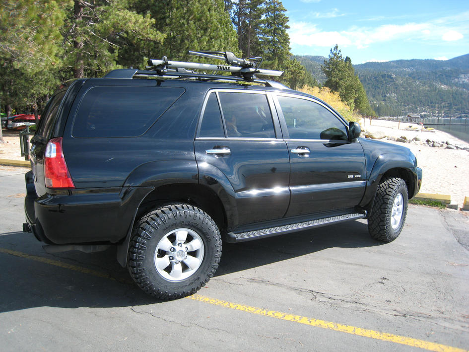

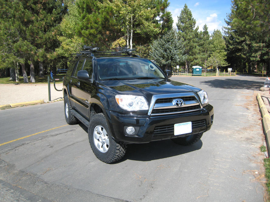

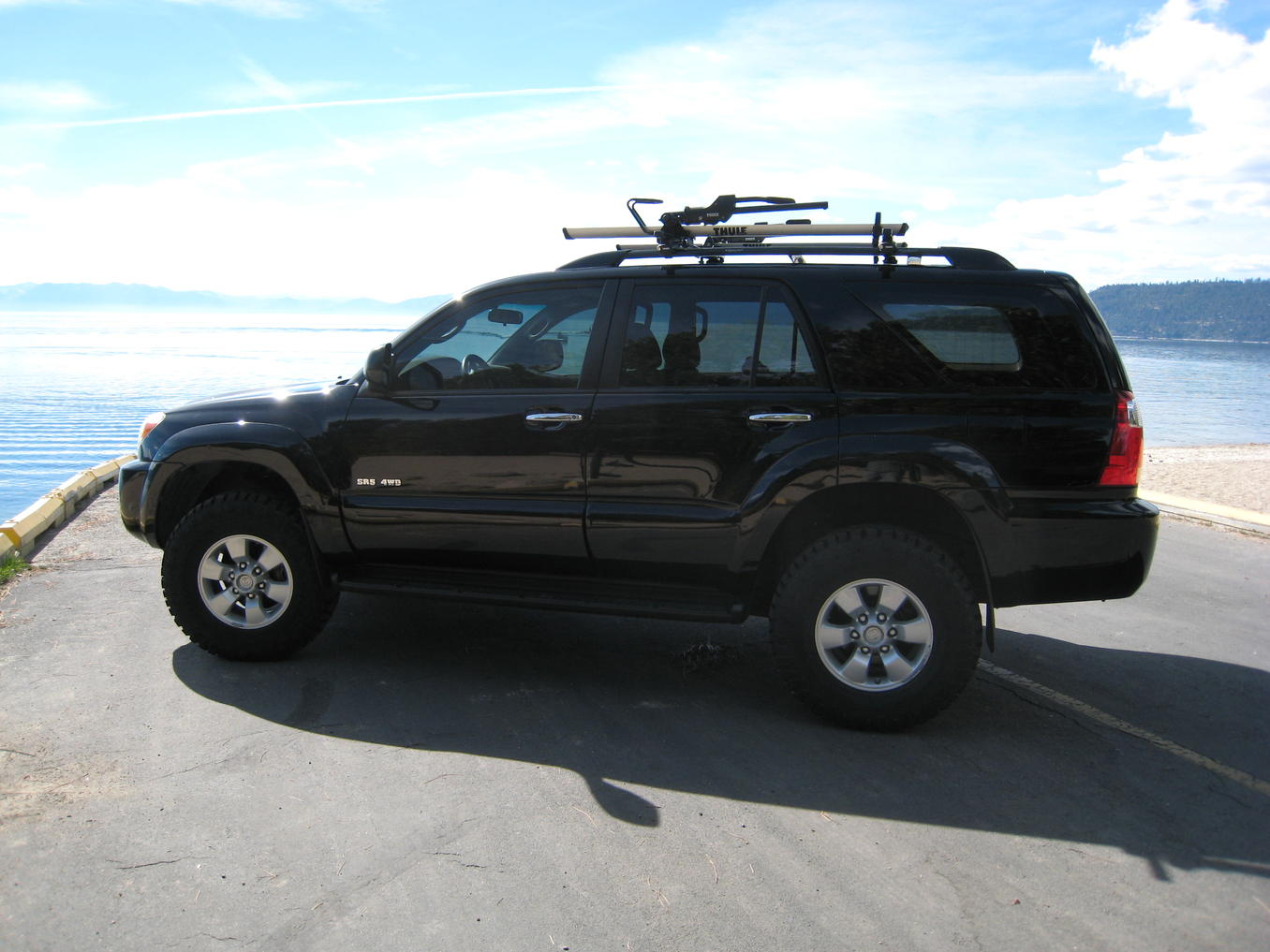

Finished the install this weekend. I really like the way it turned out. The ride is awesome, if you can get a FJ suspension, do it! It took me a full day to do it solo. But it is worth it. :driving:

So mtnbiker: You ended up doing the FJ suspension with a 2" lift in front and 1.5" in back? Do you have any shots straight on from the side so we can see the stance better (hard to judge when it's at an angle). Also, do you have before/after measurements of the wheel wells and running boards? I'm planning to do this too but with a DS 2.5/1.5 and I've been thinking about machining the fronts down slightly. Thanks for the help and pictures.
