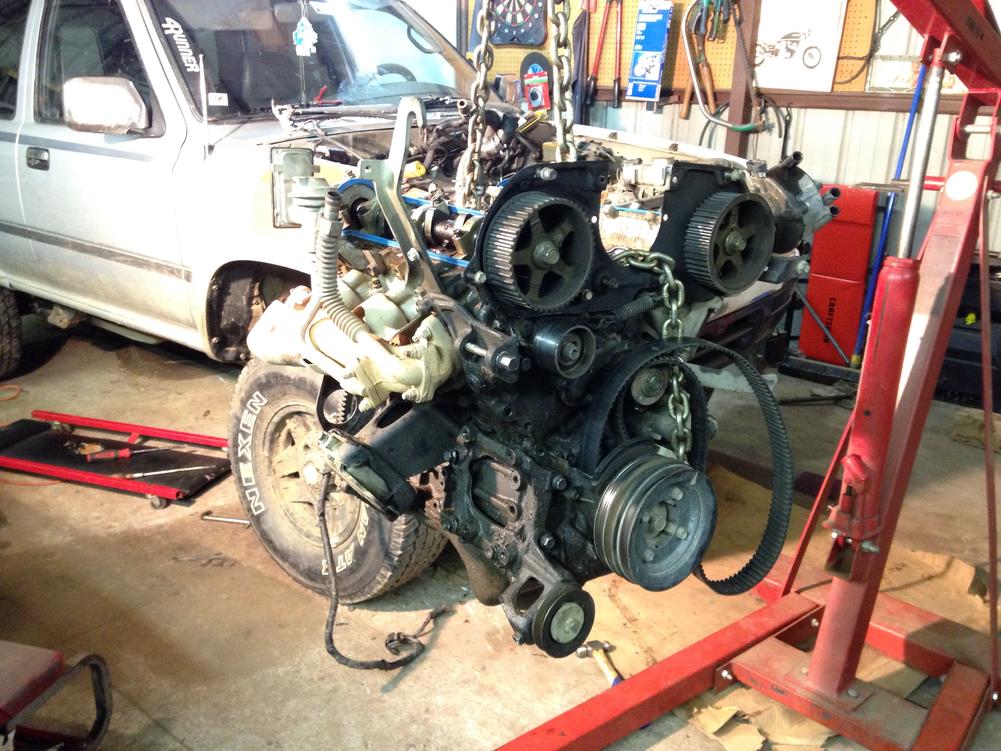

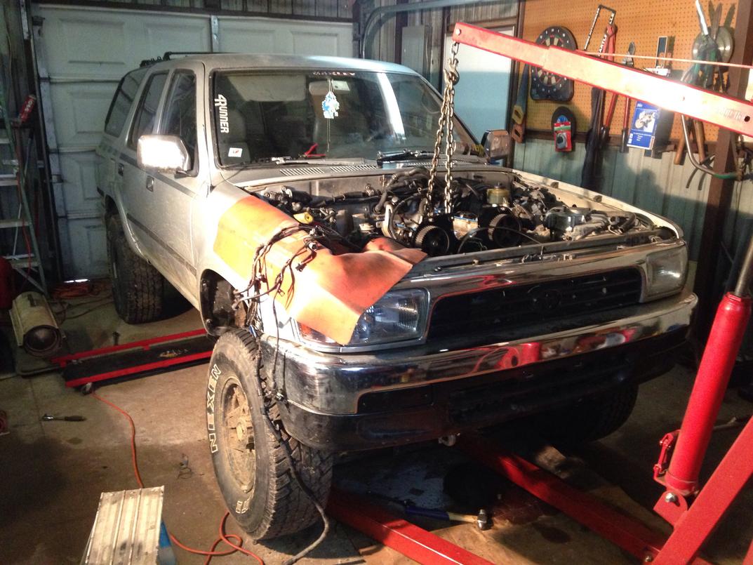

Finally got it out tonight! Now just gotta start swappin over parts and buying the new necessary ones, and the new engine will be ready!
Okay so last night I ordered a Gates water pump, Dayco idler and tensioner pulleys for my timing belt, OEM bimetallic valve ($60 for that little SOB), a new air intake hose, and tomorrow I'm buying a new starter and power steering gear box (mine is leaking unfortunately, that's $250 itself), along with all new vacuum lines. I'm still looking around for the fuel pressure regulator, is there any brand or anywhere specific anyone reccomends? Also, I have a new catalytic converter, muffler, and I bead blasted my exhaust manifolds so I can coat them with a silver header paint. It's gettin there slowly but surely!
