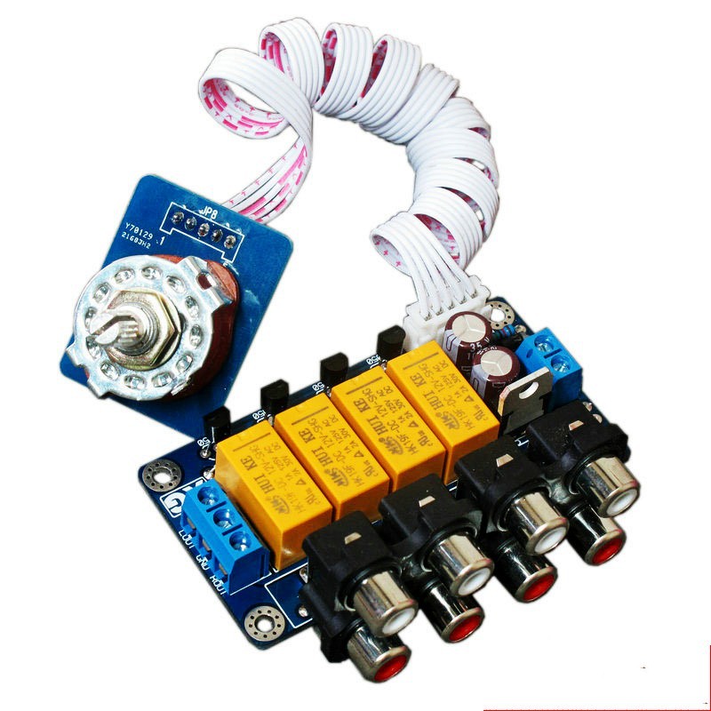

What have you used as an input selector for the RCA video input? I'm thinking about using one of these in the overhead "SOS" button place.
  • 1pcs-Four-audio-font-b-source-b-font-font-b-selector-b-font-font-b-switch.jpg
