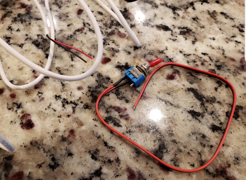

Is this switch for the Nav override so you can switch on and off?

That’s exactly what it is. Just got my kit yesterday.
It’s nice that we have the option to turn it on and off, but I have been trying to figure out a time when I would need to turn it off....?
Wondering if it’s possible to bypass the switch all together and just have it constant.
As simple as connecting the red and black together on the white wire...?
Maybe someone can chime in.
So I asked this before ordering.
It's advised to leave it turned off so the GPS can update more efficiently. Only switch when needed.

“Update” in what regards?
This is the response I received:
"It can be left on all the time but we advise using a switch because when overridden your gps position on the map will not smoothly update so that is why we recommend the switch."
