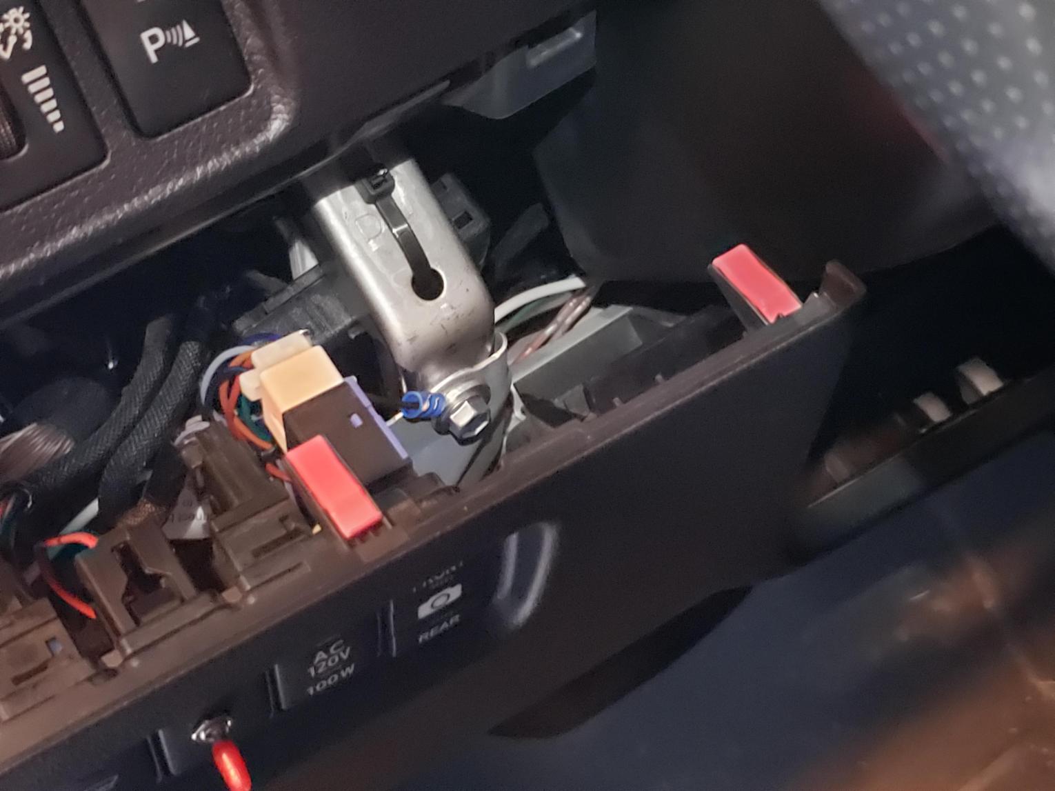

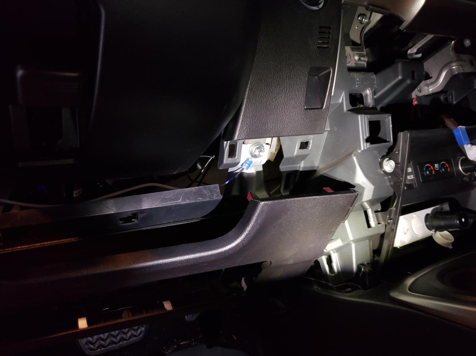

What is everyone using to ground the “Black” wire off the switch?
Maybe this is the common issue?
I grounded the switch ground and the relay ground to the following bolts pictured below. The front camera ground was connected to bolt connected to the body in the engine bay (not pictured). I'm no electrician or mechanic so let me know if these are not proper grounds.
