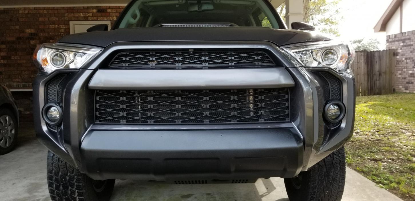

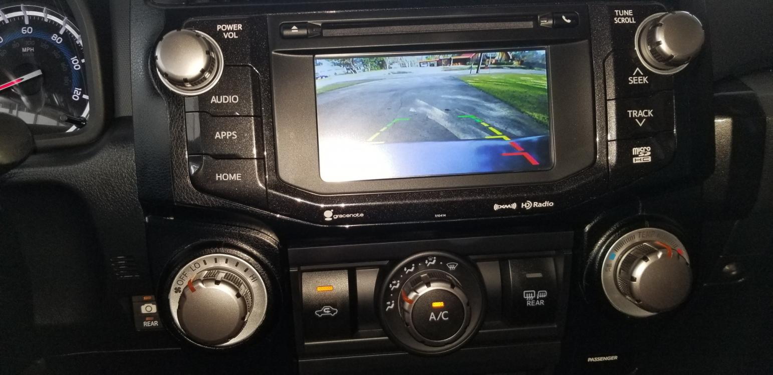

Install complete. Nice that the front has the reference lines.
