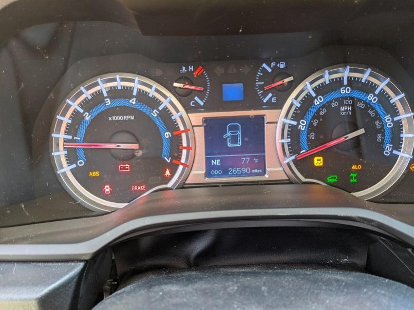

2016 Trail Premium. Decided to finally install my Anytime Backup Camera kit that I bought a couple of years ago and deep clean the center console.
1.) Truck was fine before, no dash light so I did something wrong during the install...
2.) Pulled the center console, and stereo - disassembled center console and washed all non-electric parts, let dry and reassembled everything.
3.) Plugged in the patch harnesses and switches to test before soldering etc.
4.) Turned on with the result of - a.)bunch of dash lights, b.)no rear camera, c.) Shifter lockout wont disengage.
4a.) Think I plugged the AC control plug into stereo by mistake....
5.) Pulled fuses and everything looks ok. Disconnected battery for 20 min, same issue.
6.) Can't have nice things.... discouraged...
7.) No Engine Codes per scan gauge.
Anyone have a similar problem?
Dash lights currently lit: ABS, ALT, Brake, Traction Control, 4Lo - 4x4, Power Steering Pump.
I am getting 13.2 volts with engine running per scan gauge.

Are there particular ones that I should focus on?
I did remove the Anytime Backup Harness but still have the same issue.
Check continuity of the fuses. Sometimes they look good but they aren't good.
That actually worked. PM me your venmo and I will send you $10 for a beer on me.... It was the #16 fuse, looked fine, I just pulled it and replaced it and everything worked..... literally spent 3 plus hours on this today. So relieved.
