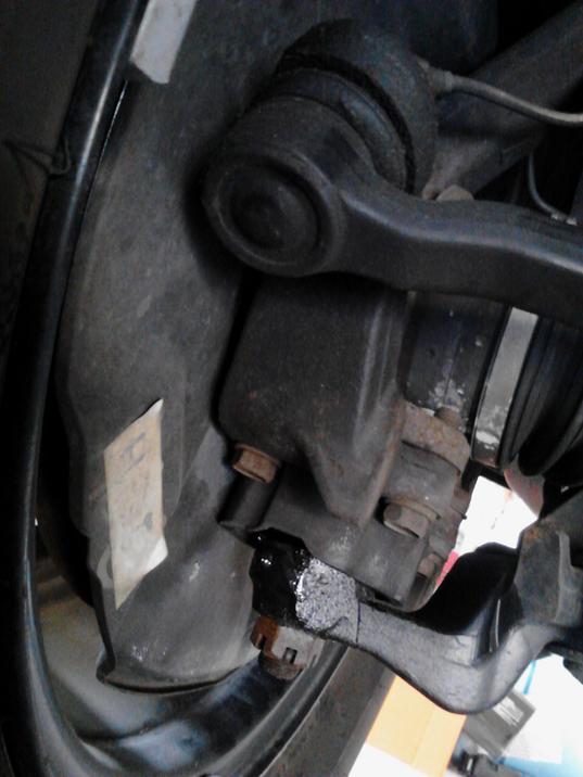

Hey Tucson, do you see anything like this on yours(see the grease in the pic? i'm Not sure what part that is, some sort of control arm, maybe the lbj itself, i have no idea?
Don't want to hijack your thread, but i get a similar sort of clunk, rubbing action when I back up and turn the wheel hard left, and stop and turn hard right and start going forward. This is my drivers side, (where the noise is coming from) and you can see in the pic that grease doesn't show up like that on the passenger side. Is this my drivers lower ball joing going bad? I was under there about a week ago when I first started trying to diagnose it, and I wiped the grease off at that time. This pic is from yesterday, you can see its back again.
I've been trying to dig through all the lbj threads to self-diagnose, but haven't had much time as I would like, so i've got to ask for help, and figured maybe it would help out Tucson (or anyone else for that matter). Like Tucson indicated above, I couldn't really feel alot of play in the wheel while jacked up either, so right now I just have the noises and the grease to go off of.

Tried looking under there today didn't see and grease in that spot. I'll jack it up after work and check again
Hmm, its so weird. I'm still perplexed (unfortunately I just don't know enough about the subject and can't find the time to really study it), but I have to assume that its got to be coming from the ball joint as there's no other place that I can think of for that grease to come from, and it keeps re-appearing. I went ahead and ordered a new lbj yesterday from napa and plan on picking it up today, so i'm going to just go ahead and swap it out regardless (i figure its to important of a piece to leave alone, even if its fine, my life is worth at least $78).

You're in the same boat as me Tucson and after replacing the lbj, I see that the upper is clearly going bad (although not quite as bad as yours yet). I just paid $50 for Napa Premium, worst part is though my mechanic wants to charge me about $240 for labor to replace it out. I'm thinking if I can get the truck in the garage I can just remove the uca while i'm switching in my new OME coils and just take him in the uca to press the old ubj out and press the new one in. Hopefully save me some money?
